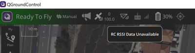

Everything looks correct and I can see the communication between the QGroundControl, the FMU and RC unit. However, the drones does not respond to the RC when in manual mode. I do see the icons of RC moves in the QGC when I move them but the drone does not respond.
Also, the RC RSSI icon in  QGC does not show any value and cliams not connection.

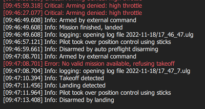

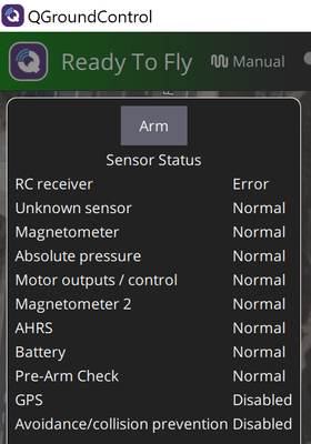

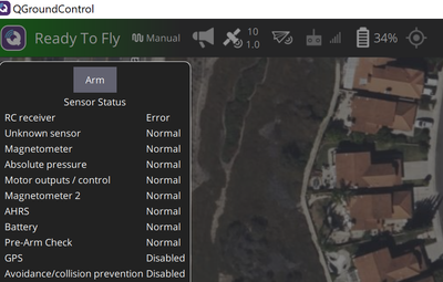

Yes, I did and the motors spin in "altitude" and "mission" and "hold" flight mode upon "arming". However, in the "manual" flight mode, I get the following message:
Also, the in the window of QGC, I see the "RC receiver" has error and no "RC RSSI data":
However, The RC kill switch (SWD4 linked to Channel does work and when I activate it, the motors all stop spinning. In "mission" and "Altitude" flight mode also, the RC joysticks do some work on speed on the motors but just  does not look right. I hope this information helps.

1) The RC connection looks is partially there. The kill switch works and I see the movement of icons in the QGC during the calibration and after. Also in "Mission", "Altitude" and "Hold" flight mode the drones seems respond to RC partially.

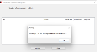

2) Done. A few times. Still same. The QGC always shows this RC receiver error
Also, the RC firmware does not get updated. It claims that it can't be downgrade to earlier version. See below:

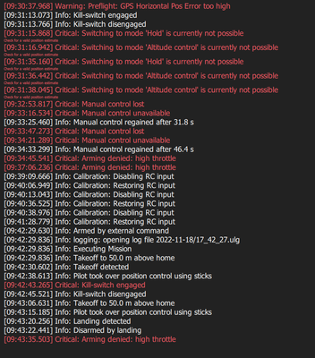

4) I will post it on the dronecode discord. Here is the log file:

The drone works in manual mode now. The problem was using the QGC in Windows. Once I used the QGC in virtual machine / linux, it started responding.

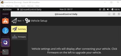

4) Does the radio show up in QGC at all?  Can you add it in connection manager?
No it does not. If I don't connect the FMUK66 to the laptop via USB, it only shows the summary and firmware section on the QGC:
