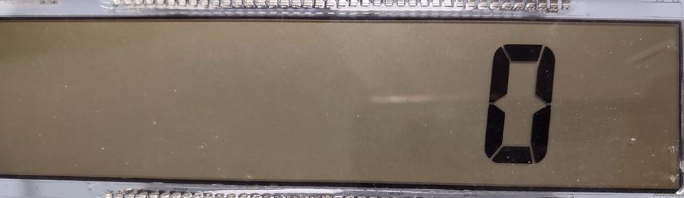

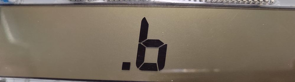

MircoCpt
I'm attaching 2 images of two PCBs with old and new driver, supposedly connected in the right way.
As you can see, the segments are inverted (DP=a, d=e, g=b, f=c) and the position is also wrong.
It screams "hardware issue", but the hw designer is confident.
Display OKDisplay OKDisplay FaultyDisplay Faulty
3,862 Views
MircoCpt
For info, if I mirror the segment data byte (e.g. 11001001 -> 10010011) the character is displayed correctly, albeit in the wrong place.
