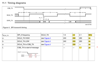

    When communicating with mc33664 via spi, must the high and low levels of sclk be strictly maintained between 240ns and 260ns, or is the corresponding delay set according to the frequency of SPI frequency, with a maximum value of 240ns and a minimum value of 260ns?
    In addition, I hope to provide an initialization register writing instruction(such as 00 00 00 01 31 7B) and a corresponding register reading instruction so that I can confirm that my communication is working.

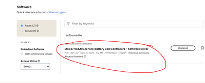

That's better for your refer to our example code firstly then porting in your side.
https://www.nxp.com/products/MC33771C?ticket=ST-704-cN1mrl5w-tUifVP9OeiwNd0dYC8-nxp#mySoftware
You can download it from below link:
Thanks!
