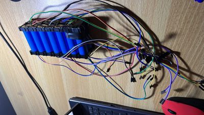

I’m working on a Battery Management System (BMS) graduation project using NXP tools:
- Master: KL25Z
- Transceiver: FRDM-MC33664EVB
- Slave: FRDM-MC33771BTPL EVB (connected to battery cells).
### Current Setup:
1. Battery Pack: 14 Li-ion cells in series (as shown in the attached image).
2. Wiring to Slave Pins:
- Positive terminal of the entire pack (Cell 1+) → Split into 4 wires → Connected to pins 1, 2, 3 (and pin 4 left open).
- Intermediate connections:
- Cell 1- (Cell 2+) → Pin 5
- Cell 2- (Cell 3+) → Pin 7
- ... (continuing sequentially).
- CB Pins: Left unconnected (no external balancing resistors).
- ISENSE Pins: Currently floating (unsure how to wire the shunt resistor shown in the image).

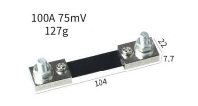

2. ISENSE Resistor:
- The attached image shows a 100A/75mV shunt resistor (127g, 104, 7.7).
- How should I wire this to the ISENSE+/- pins? Is this resistor suitable for current sensing?

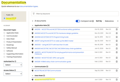

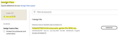

[A] If you have 14 Cells, then all pins should be connected to the battery pack. Please download and refer to the FRDM33771BTPLEVB schematic. You can download the schematic from the FRDM33771BTPLEVB product page, under the Design Files->Secure section.
There you can also find the shunt resistor connection. Please note, you need to have signed NDA with NXP and you need to be registered on the nxp.com to be able to download any confidential file, including the design files

[A1/2] If you have 14 Cells, all the CB pins and CT pins must be connected. Each Cell is controlled individually by the MC33771B. Please refer to the FRDM33771BTPLEVB schematic and/or to the MC33771B full datasheet. Shunt resistor connection is also described in there. Full datasheet is available in the MC33771B product page, under the Documentation->Secure section.

Dear Abdallah,
if you don't want to use the ISENSE pins, please connect them to the GND.
If you want to use the ISENSE pins, then a shunt and external circuitry need to be used as described in the section 13.2.4 in the MC33771 datasheet.
