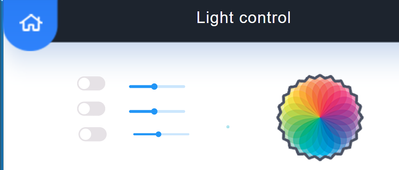

Hello all.
I am using the Gui Guider 1.4.0 to create easy sample for RT1170 promotion demo.
The widgets of switch and slides shows well in the simulators (C language)

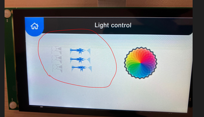

However after I write and run the project into target RT1170 with LCD(RK055HDMIPI4M) ,the widgets shows changed and deformation as following pictures
By the way I just add these switch and slides widgets by default without any modification.

Hi @ZHOU_XIAO
There is one workaround for this, you can disable the VGlite under LvConf of IDE setting.

Hi @ZHOU_XIAO ,
I just see this bug is fixed in new version, GUI Guider v1.4.1 RC2. It is in field trial.
