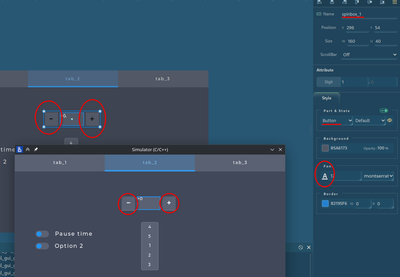

Hi, I am trying out the spinbox, here is a short list of issues/suggestions:
- "+" buttons color aren't updated (see the screenshot)
- the value is not centered by default (caused by padding set to 0, removing the padding in the generated code fixes it)
- I haven't seen a way to set a value range or rollover.
- [minor] we can also see that when the precision is 0 (after the point) there is still a point in the preview

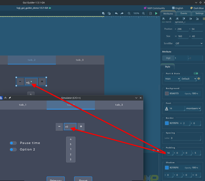

Also the padding isn't right compared to the real application:

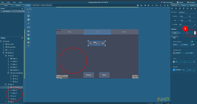

I found what is causing the button color to not be refreshed, when putting the spinbox precision/decimal to 0 (on the screenshot it is annotated as 1) Gui Guider enters an unstable state where things break. It also prevents some widgets to render

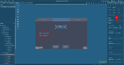

here is the behavior with a precision/decimal other than 0 (we can see the widgets render):
I also attached the guiguider file, so you can see what is going on
