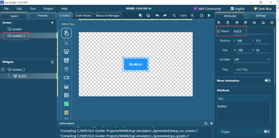

Hello @bosnian_beast
Thanks so much for your valuable suggestions, I will report to Development team.
For "GUI guider doesn't allow to give the same name to widgets in different screen (while if I manually set them to the same name in .guiguider file, it works)", I tested on my side, it seems the V1.6.0 has already  support this fucntion.
Alice
