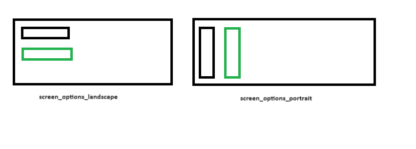

bosnian_beast
I want to create two versions of the screen in gui guider, one for horizontal, one for vertical placement. I just need the widgets to rotate, not the screen, not to do any lvgl coding, not to rotate display pixels, not to change the resolution, everything stays the same, only widgets rotate.

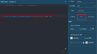

     Please follow the below steps to rotate the button:
1. set the screen background opa to 255.
2. write some codes in the current screen custom code.

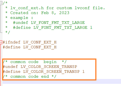

3. enable LV_COLOR_SCREEN_TRANSP in project/custom/lv_conf_ext.h.
    Hope to help you.
Liubin 

bosnian_beast
I want to create two versions of the screen in gui guider, one for horizontal, one for vertical placement. I just need the widgets to rotate, not the screen, not to do any lvgl coding, not to rotate display pixels, not to change the resolution, everything stays the same, only widgets rotate. I also need it to be a what-you-see-is-what-you-get, I don't want to guess how it will look like by manually inputting angles, x,y points etc... without seeing how it looks like beforehand.  Take a look at the options screen for example:
