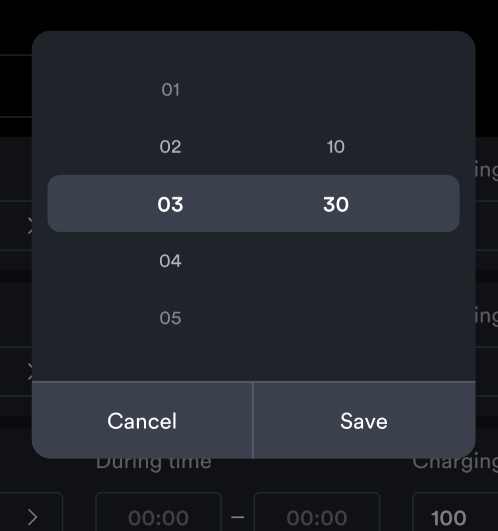

I want to set the time like the iphone, can guiguider realize this function.
2,807 Views
Cui5222
I just want to diplay the textlabel like clock, not display time so i do not need to get the value of the RTC.
It just like the drop-down list, but it have two list to set the time both hour and min.image.pngimage.png

Hi @Cui5222,
I understood you wish to have a time selector like the calendar widget but for timing; is this correct?
In that case, you would use a timer module instead of the RTC, but the implementation of the scroller that selects hours and minutes would still have to be done manually using custom code.
BR,
Edwin.

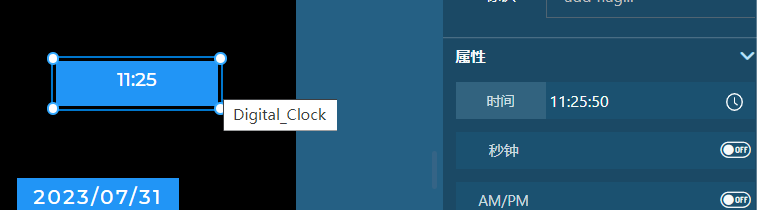

So can gui-guider realize this function. Can the digital_clock module setted manual,or use other module.image.pngimage.png
2,772 Views
EdwinHz
Hi @Cui5222,
I'll pass this recommendation to the GUI Guider team. I'm sure they will find it useful.

Hi @Cui5222,
You could do this using custom code, like described on the following post: How to display time - How-to - LVGL Forum.
As seen there, you can have custom code get the value of the RTC, and then display it on a text label. If you wish to set a different time, you could change the initial value of the RTC.
