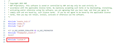

It will be generate into top of events_init.c:
In one GUI Guider project there's only one events_init.c/h file will be generated, it handles events for all screen.
