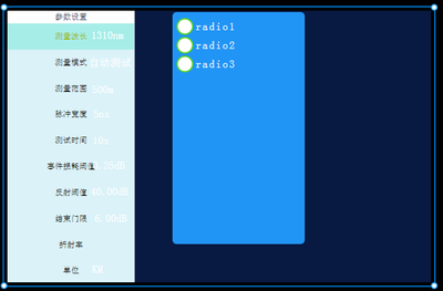

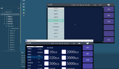

菜单里放置的其他组件为什么移动不了位置?我加了个容器在容器里移动位置的话仿真可以看到,但是在绘制界面里看不到。

Hi  @RayC02 ,
Could you provide more information about your application?
What MCU are you using? How are you handling the container? You mention you see the items move in the simulation but not in the actual display, am I correct? If so, what do you see on the display?

We should be able to discern if this issue is caused by a bug or a misconfiguration by using the "DashBoardMenu" example project as base for the usage of the Menu widget. This example also has a Menu, with several components inside of it including sliders, labels and containers. As you will see on this demo, only one page can be viewed on the drawing interface at a time. Also, note that under "Part & State" most of the widgets inside of the menu have the "Default" state, meaning they will inherit their style from the default state. I believe in your project you may have some of these widgets as "Checked" rather than "Default", meaning that they will only display once a specific event has occurred, like when they were selected on the simulation. This may be the cause of you seeing the items on the simulation, but not on the drawing interface.
