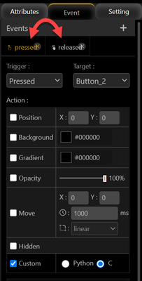

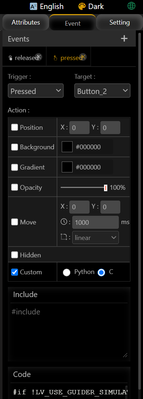

For those who struggle with white screens as well, I hereby update this post with the reply from Ramon (his reply on the NXP case 00509127). Reversing the order of events (as Ramon suggests) indeed solved the problem of 'running into 'random' white screens while using the Gui Guider tool.
Summary: in case you use 2 types of events at the same time, make sure to define the 'Pressed' event first, then the 'Released' event
>>> RAMON <<<
I had the opportunity to review your project and in this time I was able to find the problem. I noticed when we use more than one event the order matters, to avoid the white screen the event with custom code should be first and then others.
I never seen this error before, anyway I will report this bug to our development team.
This order in the events will trigger with screen
With this order the problem is solved.
