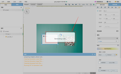

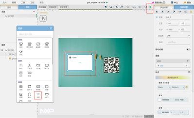

1.如下图,添加List 控件后,点击运行程序,发现一直处于卡死的情况,这可能是个严重的问题

Hi @YoungWind
   After investigation, This is the root cause. it was found that the default font was deleted from your project. and the preset style used.  So, you can create a new project with the local project.
By the way, we will add the missing font check for Gui Guider. Thanks for your report.

LiubinGong
Hi @YoungWind
    I just tried to run the simulator with the same as your project. It works fine.
So would you describe it in more detail? or give a simple example project?

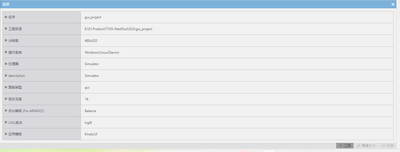

      附件是我上传的demo,我还是无法运行它(我的系统windows 11,64bit,16G运行内存),以下是我的工程配置:
1.工程配置

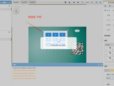

2.我又发现了更多的问题,添加以下控件后都无法运行

LiubinGong
Hi @YoungWind

YoungWind
非常感谢!确实是我删除了默认的字体导致的。
