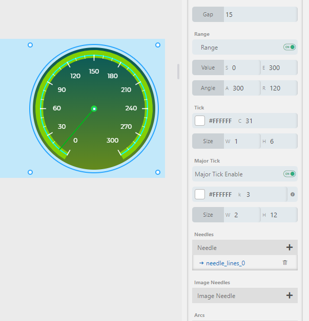

GUI-Guider自带的Meter控件刻度显示不正常。譬如:我要Meter显示值从0~300。每小格是10。但显示出来的刻度是乱的,最终的最大刻度也每显示出来。另外,Meter控件不能显示负数刻度,能否设置显示负数刻度?

Hi @alen-liao,
please configure the Meter attributes with correct values, according to your description you could refer this configuration:
And now the GUI Guider cannot set minus value to the meter range, we will consider it as feature in the future release.

alen-liao
谢谢!问题解决了。
