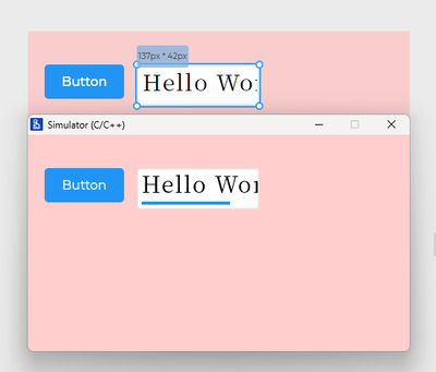

        GUI-GUIDER的文本框的不换行模式(One Line Mode)设置为ON,但在模拟运行时文本框Textarea还是显示了换行标志以及文本内容能上下拉动。

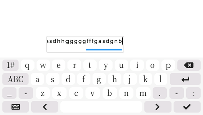

文本框的不换行模式(One Line Mode)设置为ON后,文本框的显示不应该像2.png那样显示一个竖条,而且文本不应该能上下移动。

Hi @alen-liao,
This issue is caused by widget size and font size, if the font height is greater than widget size, the text area will be scrollable.
To avoid this issue please modify the widget height and padding,  or you can just add custom code to the screen to make the widget fit text size:
lv_obj_set_height(ui->screen_ta_1, LV_SIZE_CONTENT);
Hope it helps.
Wenbin

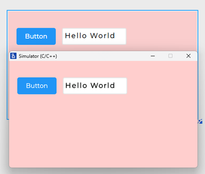

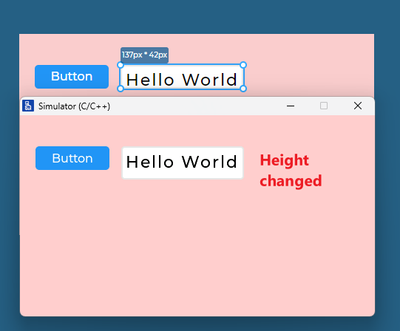

Hi @alen-liao,
The lv_obj_set_size() function will overwrite size of lv_textarea_set_one_line(), so text area will be scrollable while the object height is smaller than text font height, but it's still in the one line mode since the text always keeping in one line.
If you call lv_textarea_set_one_line() after lv_obj_set_size() the object height will be overwrite by the text font height, which will cause inconsistent effect between editor and simulator/target.
Default:
call lv_textarea_set_one_line() at end:
We are trying  to make sure that the editor and the actual effect are consistent, and this is why I suggest you adjust widget size, padding and text font size to get a better result.
