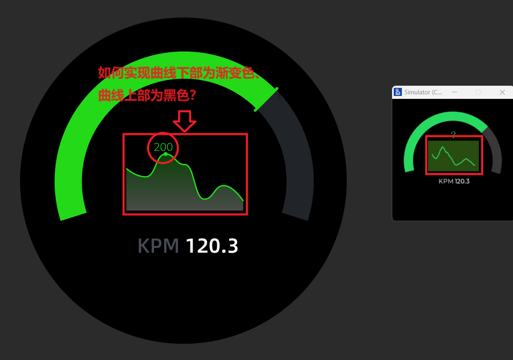

请问如何实现曲线下部为渐变色、曲线上部为黑色?以及最高点数值圆点如何显示?

Hello @CHD
How about refer to:
https://docs.lvgl.io/8.3/widgets/extra/chart.html#stacked-area-chart
