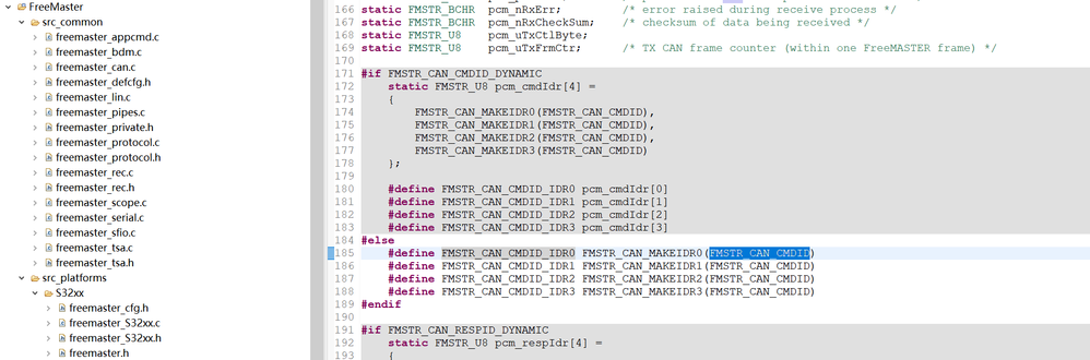

Dear NXP engineers, happy Chinese new year! I have a question regarding the use of FreeMaster. When using CAN communication, I would like to change the communication ID to use extended frames. What modifications or changes are needed in the FreeMaster low-level driver configuration for this purpose?

Unfortunately, FreeMASTER Driver for S32K1 is outdated and does not support Extended CAN IDs.
However, it was implemented in later versions targeting new NPIs (ex: S32M2) which should work out of the box with S32K1. The drawback is that, in S32DS, FreeMASTER Driver for S32M2 cannot be attached to a S32K1 project, meaning you would need to do the integration manually.

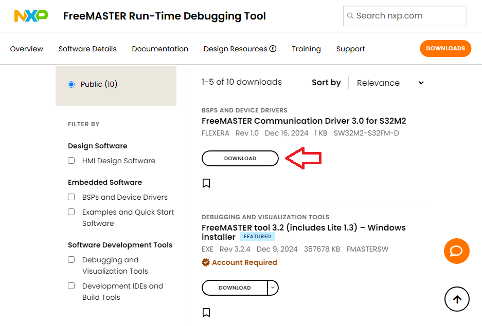

1. Download FreeMASTER Driver 3.0 for S32M2
2. When you get to Flexera page, select FreeMASTER Driver source code

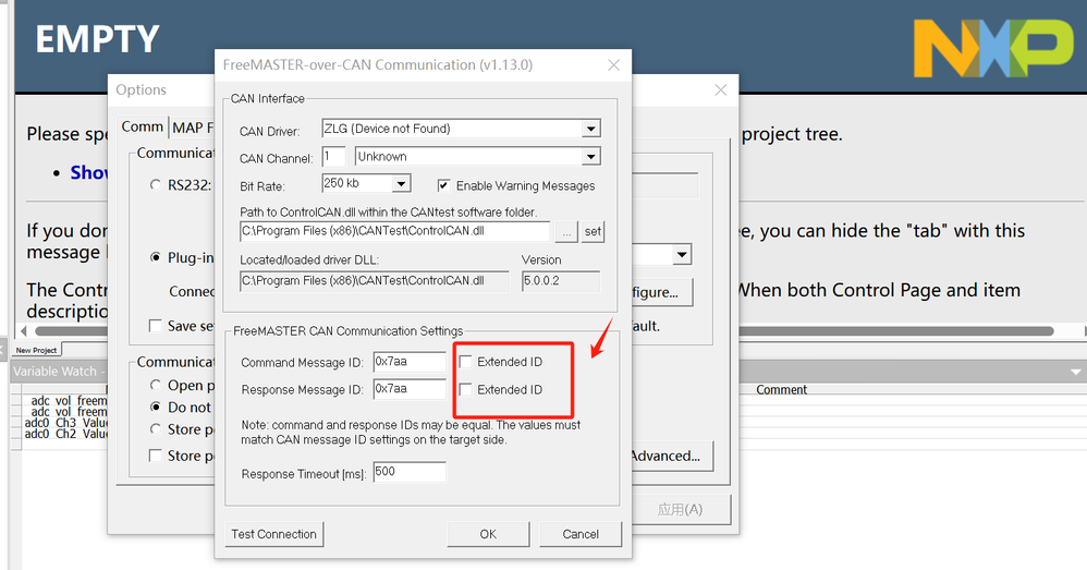

#define FMSTR_CAN_CMDID 0x800007AAU
#define FMSTR_CAN_RESPID 0x800007AAU
If the most significative bit of FMSTR_CAN_CMDID  and FMSTR_CAN_RESPID is set to 1 as in the example above, FreeMASTER will use extended IDs. In this particular case, the desktop application should use Command ID 7AA with checked Extended ID.
