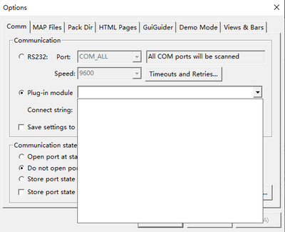

freemaster can't find any plug-in module item
1,604 Views
JhonYF
MCU:s32k344,    Debug tool:PE&M  Rev E,

this happens when the FreeMASTER is not installed or when there is a problem with obtaining administrator rights during installation.
Easy fix is to run the register.bat "as administrator". This file is in the installation folder, by default at "c:\NXP\FreeMASTER 3.2\FreeMASTER\register.bat"
