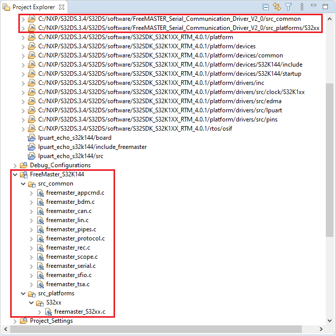

I am trying to include the freemaster SDK 2.0.0. After including this SDK i am getting following error.
make: *** No rule to make target 'FreeMaster_S32K144/src_platforms/S32xx/freemaster_S32xx.o', needed by 'LED.elf'. Stop.
"make -j8 all" terminated with exit code 2. Build might be incomplete.
Please suggest how to resolve this error ?

Hi @Dinesh_Guleria,
Usually this issue is caused by some missing files required during compilation (may be caused by relative path or how those files were included into the project).
Are you including FreeMASTER SDK manually or using S32DS feature to attach the SDK ? Note that when you attach it - S32DS does not copy the files into your project by creates a symbolic link.
Could you check whether S32DS is able to locate correctly includes folders and links to source code files.

After installing freemaster tool from this website, then using S32DS feature I attached the freemaster SDK , what i found this error is resolved:---
https://www.nxp.com/design/software/development-software/freemaster-run-time-debugging-tool:FREEMAST...
Actually i did not instatted this software previously & was using S32DS feature to attach the freemaster SDK. May be this was causing this error ?

FreeMASTER SDK is also part of one of the S32DS S32k1xx Development packages and is installed in (C:\NXP\S32DS.3.4\S32DS\software). I guess you did not have it installed. Happy to hear that you were able to solve it.
