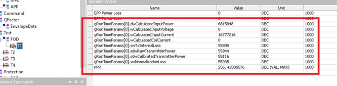

I have below readings values with automotive MP-A9 Wireless charging, using WCT1013A.pmp (I didn't flash the board with CodeWorrior).
Are these values accurate? How to convert them to real values?
gRunTimeParams[0].dwCalculatedInputPower: 6815848 (DEC)
gRunTimeParams[0].wCalculatedInputCurrent: 16777216 (DEC)
gRunTimeParams[0].sdwRawTransmitterPower: 55944 (DEC)

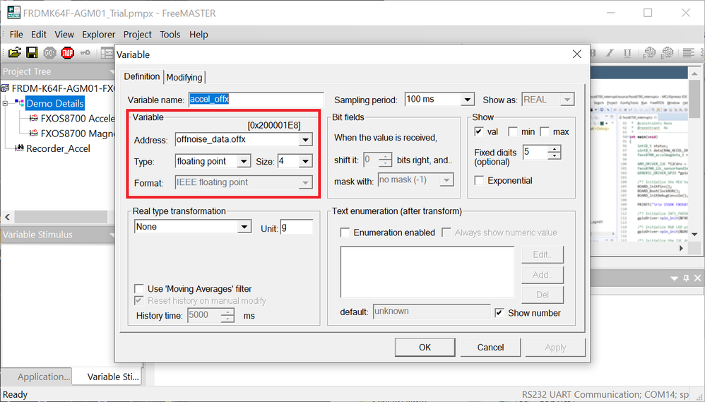

FreeMASTER displays the values from the embedded defined by a memory address and size. The correctness / accuracy of those values depends on the embedded application. You can find those in variable definition window. Navigate to Project→Variables...
In the popped up window select your variable of interest and press the Edit button
The details screens contains the data used to read variable values

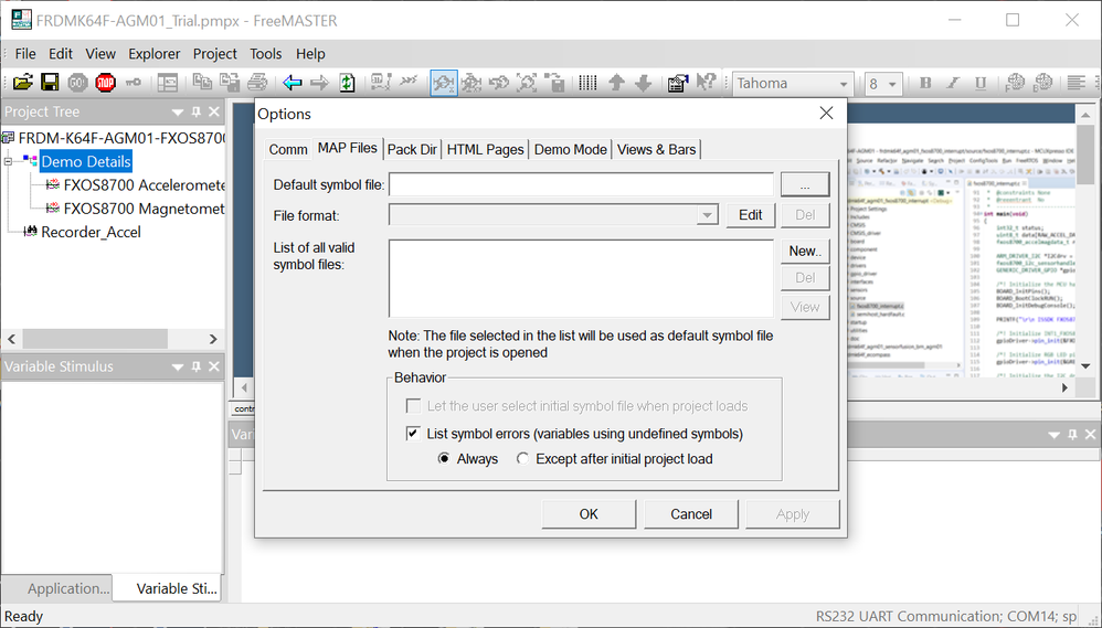

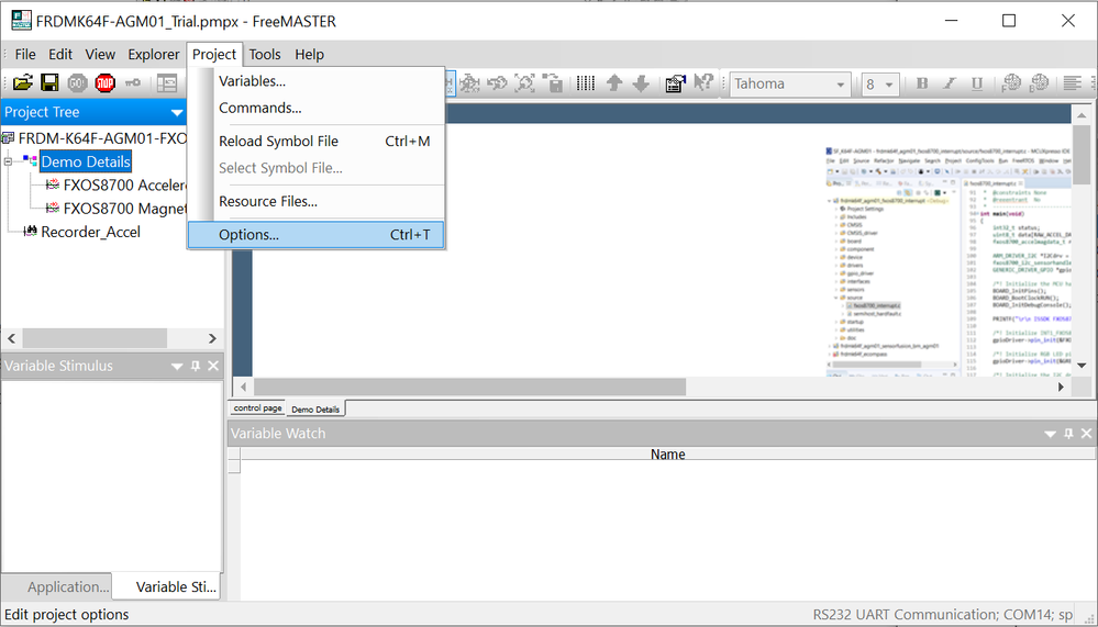

The address field contains the name of the embedded variable and right above that field is the target application memory address from which the variable is read. If you flashed an elf file different from the one used during FreeMASTER project creation those may mismatch. Could you reload the elf file you flashed on the board for the tool to remap the addresses. For this navigate to  Project→Options...
And open MAP Files tab:
Press the button next to "Default symbol file" and provide your elf/map file. You can check the loaded symbols and addresses by pressing the View button.
