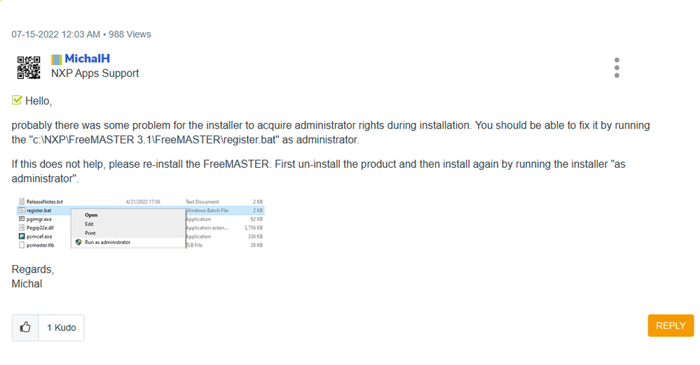

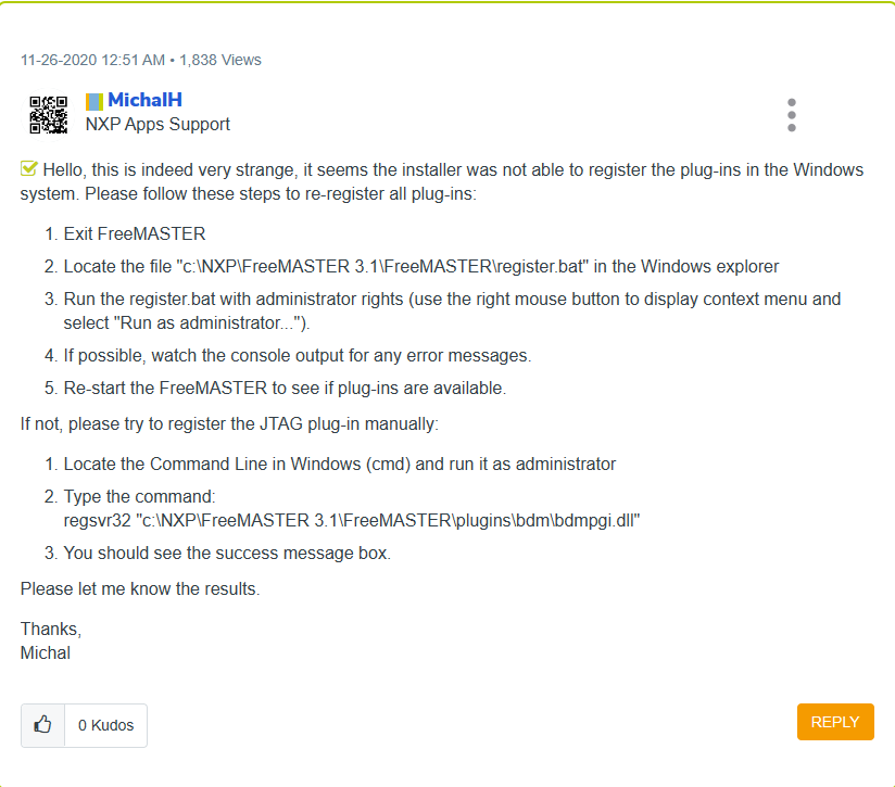

There are no plugins in my free master, and I have used the following two methods but still haven't solved them. Then I uninstalled and reinstalled it again. This time, I don't need a security code, but there are still no plugins available5V~ZU8Z4Q$H68[5_H8TFE0Q.pngL3L$UD@1OMP956W}V9O~]N1.png
