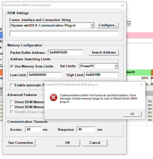

In the FreeMASTER plugin I can see that the connection with winIDEA is successful:
But it fails to find the packet buffer at the specified address (and the automatic search runs but cannot find it as well):
Why it does not work? :smileysad:

Hello Michal,
Thank you for your prompt reply. I installed FreeMASTER 3.0 but the problem persists, using either FreeMASTER 3.0 or 2.5 (I understand that the plugin is the same but I tried with both versions anyway). Here is a screenshot:
You will recognize from it that this is the new plugin (the GUI is different). Still no success. I Inserted the address and I also did a search just in case. So the problem is still there. Note that I am using a recent version of winIDEA 9.17.100 (released 9/2019). Maybe when you tested the plugin you used the previous version 9.17.39? I can't say if the problem could be here, recall that I can connect with direct memory access (so I can confirm that debugger and target are reachable by FreeMASTER). The issue is when trying to connect with PD-BDM.

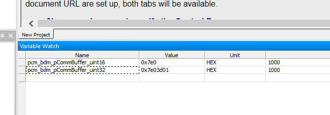

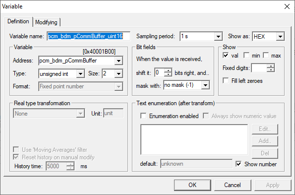

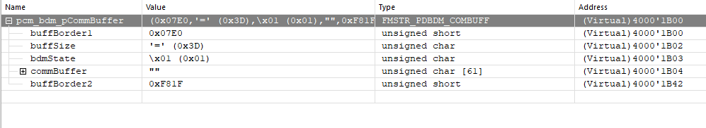

can you please create a FreeMASTER variable (2-byte unsigned int) at the expected address of the PD-BDM buffer (0x40001b00)? And please display its value in a variable watch and send it to me here. Then update the variable to 4 byte size and send me the value too.
I suspect we have a compatibility issue of PD-BDM operation and big-endian parts. I will test also locally.
Thank you for your help,
Michal
5,936 次查看
lucabarbiero
Hello Michal,
This is the FreeMASTER variable definition as uint16:
And this the definition of the same variable as uint32:
This is the FreeMASTER watch:
And this is winIDEA debugger:
Everything looks consistent though. I am available to do further checks.
