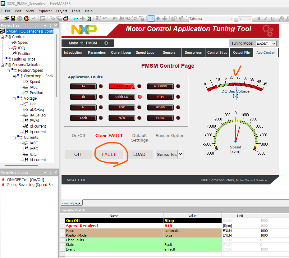

I want to check the motor operation in MCSPTE1AK344 Development Kit. However, the ON/OFF icon in the App control tab of FreeMASTER is fixed to OFF. What should I do?
[The order in which I worked]
1. Import the file in the path below from the workspace
   - C:\NXP\MC_DevKits\MCSPTE1AK344\sw
2. Double-click S32K_PMSM_Sensorless.pmpx inside the FreeMaster folder.
3. FreeMASTER runs
4. I try to press ON on the app control screen, but it appears as OFF.

trunie1
Hi. Tomas
Thanks for the answer.
Since I use the Sunrise motor, I applied the 3 changes you mentioned above.
- PMSM_appconfig.h : I deleted all the code in the PMSM_appconfig.h file on the project(at S32DS) -> I copied all the code in the file attached above and pasted it in PMSM_appconfig.h
M1_params.txt : Same as above
- main.c : I changed the code as above
Then I ran Build -> Flash on the board -> activate S32K_PMSM_Sensorless.pmp file.
As a result, a FAULT occurs...
I've written down what I've confirmed below, please refer to this.
1) replace attached PMSM_appconfig.h in  in MCSPTE1AK144\sw\MCSPTE1AK144_PMSM_FOC_2Sh\Sources\Config
2) replace attached M1_params.txt in MCSPTE1AK144\MCSPTE1AK144_PMSM_FOC_2Sh\FreeMASTER_control\MCAT\param_files
3) Replace code in  FocSlowLoop function in main.c
[Fault occurs at FreeMASTER]

tomasfedor
Hi Trunie,
updated scale for Udc voltage is correct in the print screens you posted.
So it looks to me like the board is supplied by 24V instead of 12V.
Tomas Fedor.

trunie1
Hi. Tomas
I use the power supply below, and this product outputs 12V(This product is included when purchasing MCSPTE1AK344).
I don't know why it shows 24V in the picture above.
So I measured the voltage again with a multimeter and found that it was 12V. It also appears as 12V on MCAT.
[power supply]
[voltage measurement point - DEVKIT MOTORGD]
[MCAT screen - 12V]
And it turned out that there were no FAULTs on the MCAT.(refer to above picture)
So I changed it from Off->On. But In this state, if Speed ​​required is set to 0 -> other value, FAULT occurs again... What should I do?
note1. When the 'speed required' is set to 2000(not zero) and I change it from Off to On, it becomes READY -> CALIB -> ALIGN -> FAULT.
note2. the motor did not rotate.
[MCAT : ON]
[MCAT : FAULT]

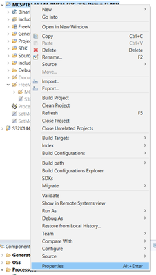

tomasfedor
Hi Trunie,
it seems that ammclib library path is not set properly.
I will analyze why it happened.
in order to fix it:
1) check the latest version of the AMMCLib you have installed for K1 in C:\NXP\AMMCLIB  S32K14x_AMMCLIB_v1.1.XX
2) In design studio open project properties (right click on project)
3) Open category C/C++ General -> Path and symbols  and update library path to correct version in :
includes GNU C and in Library paths
After this modification it should be possible to build the project.

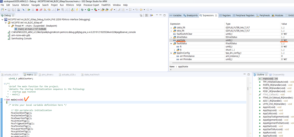

I checked how the code is executed to see if a FAULT occurs, and the process is as follows. Can this problem of continuously occurring FAULTs be improved?
- Process : main() -> AppStateMachine[appState]() -> appState value changed from 'APP_INIT(0)' to 'APP_STOP(5)' -> faultcheck() -> 'MC34GD3000 MOSFET Pre-driver error' Code is executed, faultStatus.B.PreDriverError = 1 -> appState = 'APP_FAULT(6)'
1. main()
2. AppStateMachine[appState]()
3. appState value changed from 'APP_INIT(0)' to 'APP_STOP(5)'
4. 'MC34GD3000 MOSFET Pre-driver error' Code is executed, faultStatus.B.PreDriverError = 1
5. appState = 'APP_FAULT(6)'

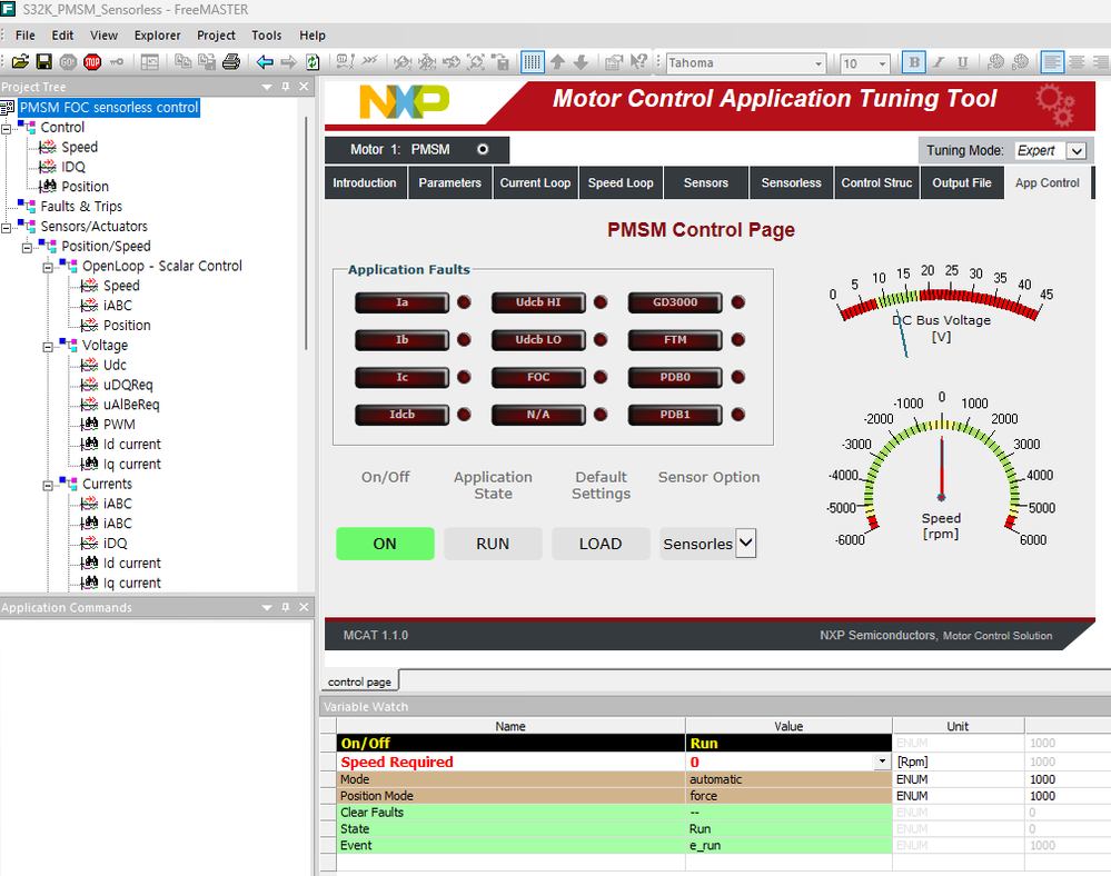

I would like to share what I found regarding the problem where a FAULT occurs when I run the MCAT Tool by clicking on the .pmp file in the project.
- actual input voltage : 12V
- DC Bus Voltage displayed in MCAT Tool : 24V (It should be 12V, but it shows 24V)
[Voltage on MCAT and Multimeter]
[measured point]
