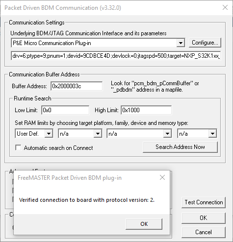

peter_shi
Hi Iulian ,
Firstly, I disabled UART communication for freemaster, and enable FMSTR_USE_PDBDM.
Second, for BDM communication, Direct access to the target microcontroller memory option seems to connect micro successfully, but input voltage can't be displayed.
Third, I tried the use access using the PD-Protocaol. It can't be working.

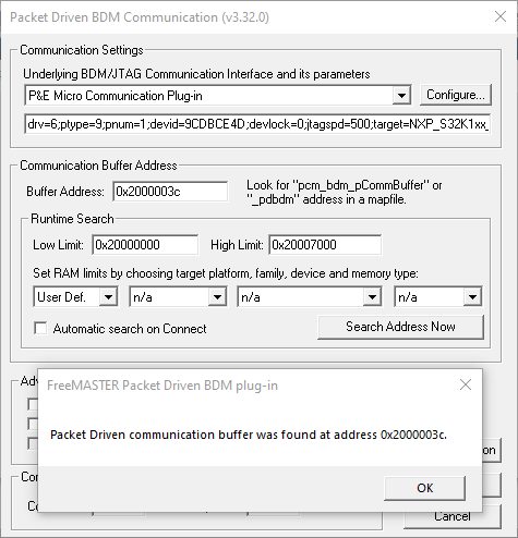

Hi @peter_shi,
According to your screen shots, FreeMASTER fails to find the "Communication Buffer" because you specified an invalid memory range. (0x0 - 0x1000 is outside S32K14x SRAM memory).
You can either:
  1. Specify the SRAM range (Low Limit & High Limit) used by your application
    or
  2. Specify directly the Buffer Address that can be found in the map file.
Here is an example:
If you specify a valid RAM range and press "Search Address Now" button, the tool will scan that range and show buffer address if it's found:Capture2.PNG
Or you can check directly the MAP file and fill in the "Buffer Address" field and press "Test Connection" button:

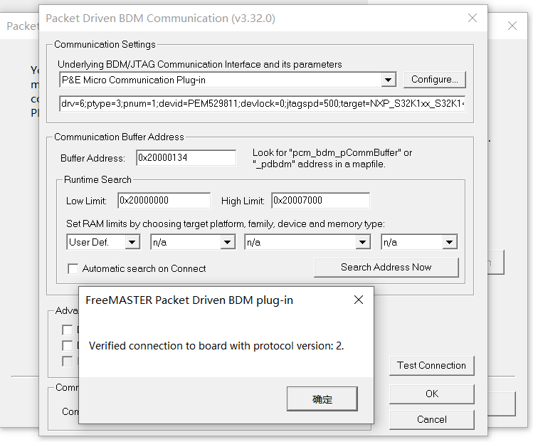

peter_shi
13,054件の閲覧回数
peter_shi
I can connect demo board by PE. But the communication speed is pretty low. Is there any other configuration to speed up? Thanksmaster1.PNGmaster2.PNG
