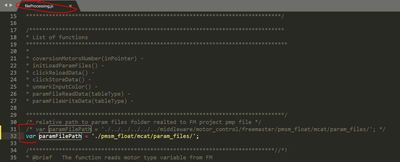

The problem is that MCUX didn't copy the MCAT content correctly to workspace (HTML pages are missing). This might be caused by some backward incompatibility (MCUX11.3 vs. SDK2.7). I don't know the real reason, you can try an older version of MCUX IDE or make a manual fix:
  1. Run the pmsm_float.pmp from unpacked SDK package: SDK_2.7.0_TWR-KV31F120M\boards\twrkv31f120m\demo_apps\mc_pmsm\pmsm_snsless\pmsm_folat.pmp OR
  2. Fix the MCAT in your workspace:
    1. Copy/replace the MCAT pmsm_float folder (SDK_2.7.0_TWR-KV31F120M\middleware\motor_control\freemaster\pmsm_float\  ->  workspace\twrkv31f120m_mc_pmsm\motor_control\freemaster\pmsm_float\joseftkadlec_1-1613722998898.png
    2. Edit (re-comment) the pmsm_float\mcat\src\JS_functions\fileProcessing.jsjoseftkadlec_3-1613723842080.png

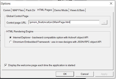

    3. Set the path to MCAT in FreeMASTER -> Project -> Options -> HTML Pages to .\pmsm_float\mcat\src\MainPage.htmljoseftkadlec_2-1613723264086.png

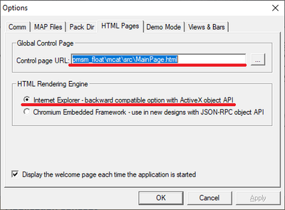

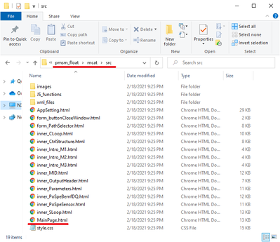

Hi @GaryOlmstead,
Could you check the following:
  1. Open project options dialog: Project→Options...(Ctrl+T)
  2. Navigate to HTML Pages tab
  3. Check that the control page URL & rendering engine are properly setCapture.PNG
  4. Confirm all resources are located in the corresponding path relative to pmp fileCapture1.PNG
If there are no issues with the above it may be a IE restriction (MCAT application is using ActiveX API and needs to be run inside Internet Explorer widget as seen in point 3 above). A possible solution, in this case, is described in this thread.
