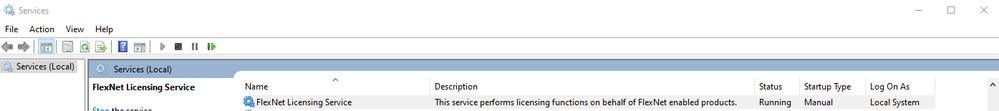

iulian_stan
Hi sushil.prabhu@sparton.com,
It seems that this one is caused by FlexNet Licensing Service - either due to installation failure or OS restriction.
Could check if it was installed on your system:
  • Is there a FlexNet entry in your system services list ?
  • Was the service executable installed in Program Files ?
    It's path should be: C:\Program Files (x86)\Common Files\Macrovision Shared\FlexNet Publisher
If one of those holds could you start the service manually and reattempt the installation.
Could you also provide your installation log (C:\NXP\FreeMASTER 3.0\_FreeMASTER_installation\Logs).
Kind regards,
Iulian
12,861 Views
sushil_prabhu
Senior Contributor I
Julian,
Thanks for this information. FlexNet Licensing Service was not running on my PC. I started it
However, it is 64 bit and the service executable is installed in
C:\Program Files\Common Files\Macrovision Shared\FlexNet Publisher
Installation of the FreeMaster failed with the same error message. How can I get this working?

iulian_stan
Hi sushil.prabhu@sparton.com‌,
In both cases your installation fails due to limited privileges. Here's the error message from your logs:
CLLReason [errorNo=5, errorString=Error installing the FlexNet Publisher Licensing Service and registers. Access has been denied to a resource, either a service or a file, or the registry. Administrator privilege is required to resolve this problem. (FNP error 1007), flxActMajorErrorNo=0, flxActMinorErrorNo=0, flxActSysErrorNo=0, flxCommErrorNo=1007]
Unless you run the installer as admin you won't be able to use FreeMASTER Lite.
Please note that only the Lite feature requires license validation. You can try installing FreeMASTER (main tool) by deselecting FreeMASTER Lite option on the Component Selection screen.
Kind regards,
Iulian

sushil_prabhu
Thanks, our company has IT managing the installation. So when they tried to install from my account and used their admin credentials when prompted, it did not work. When IT logged in as admin and installed the application, installation went through without any issues.
Thanks for your help.
Sushil

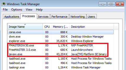

iulian_stan
Hi Gean,
Could you please confirm weather you have administrative privileges on the PC you are trying to install FreeMASTER on. The installer contains a built-in JRE and does not require nor affect any existing Java distributions on the system.
It's quite strange that it creates a folder on your C driver which happens only after user confirms installation options. Meaning it requires user input on the following screen:
Prior to this one all processing happens in a temporary directory.
Is it your first time installing FreeMASTER 3.0 on that PC?
Can you redownload the installer (in case it got corrupted) and try running it again. If it get's blocked make sure to terminate any previously launched processes before a new attempt:
In case it still persists could you provide additional information on your OS and PC specifications.
Kind regards,
Iulian
