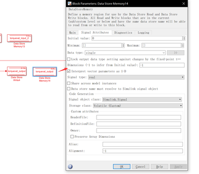

     As shown in the figure below, I use the data story memory module to set the variables as global variables, and then measure and calibrate in FreeMASTER.

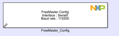

In your previous screenshot I saw that you've been using BDM plugin that does not require adding FreeMASTER module into your Simulink model. Separate modules are required only if you want to use UART or CAN interface for FreeMASTER communication (as far as I know NXP's toolbox includes example applications demonstrating these two use cases that you can refer to).

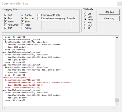

Another thing I could suggest is to check the communication log for any errors. Top menu bar: Tools → Communication Debug Log...
This screen displays the commands send by FreeMASTER tool to the target board. You can increase verbosity level to see the replies as well.
In case there are no errors means that the value at the memory location given by your variable address is most likely 0 (zero). Another thing that could happen is that the address that FreeMASTER gets from the ELF file does not point to the correct memory location, and FreeMASTER reads the 0 (zero) value from a wrong address.

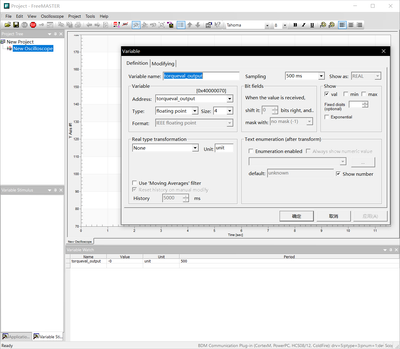

One side note: I noticed that TrackSignal_Mode is declared as float in MatLAB but is of type unsigned int in FreeMASTER.

        In response to what you said "TrackSignal_Mode is declared as a floating point number in MatLAB, but it is an unsigned int type in FreeMASTER", I tried to change the data type of TrackSignal_Mode in FreeMASTER, but it did not change. The display result is still 0.
        I want to know whether the model I built in simulink can be used to measure and calibrate variables, and whether to add a FreeMASTER module in simulink. I used NXP's MBD Toolbox MPC5744P before, without adding the FreeMASTER module, and successfully burned a relatively simple program built in simulink into the board through the same operation method, and can be measured and calibrated in FreeMASTER software.

I don’t know what this error code means.
4,051 Views
iulian_stan
This errors is related to invalid number of scope instances or number scope variables. In your case it happens because you try to create an Oscilloscope instance with no variables attached `SetupScope(varcount:0)`.
But this should not cause the issues related to the variables value because `ReadVar32(addr:0x40000070)` returns status `OK` meaning FreeMASTER was able to read 4 bytes from 0x40000070 (you can set Verbosity Level to All to see the returned value as well).
