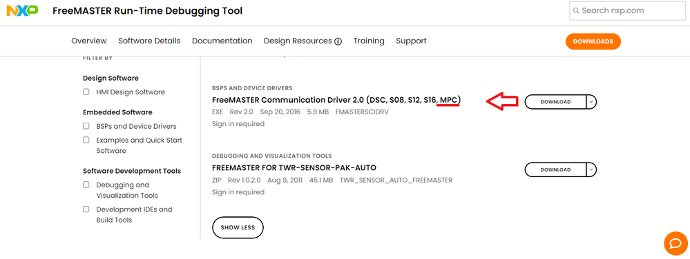

As far as I know FreeMASTER support for MPC was added in S32 Design Studio for Power Architecture. In case of CW your would need to get the FreeMASTER Driver source code and integrate it manually into your CW project.
The driver package can be downloaded from FreeMASTER's home page

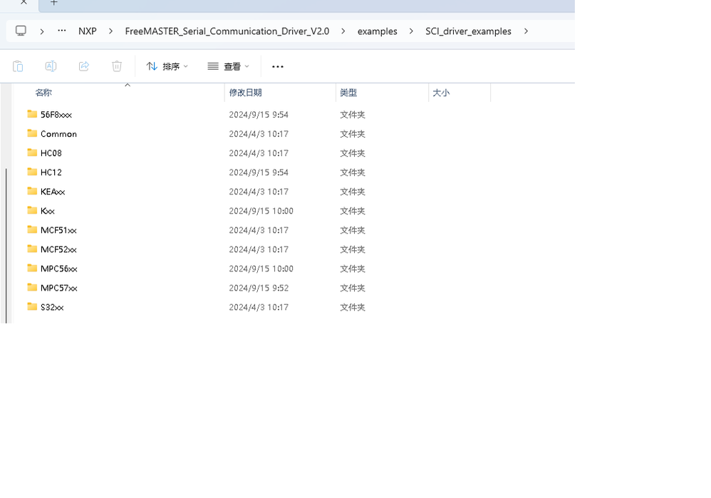

Inside the package you can find example projects for MPC56xx that you can use as reference.

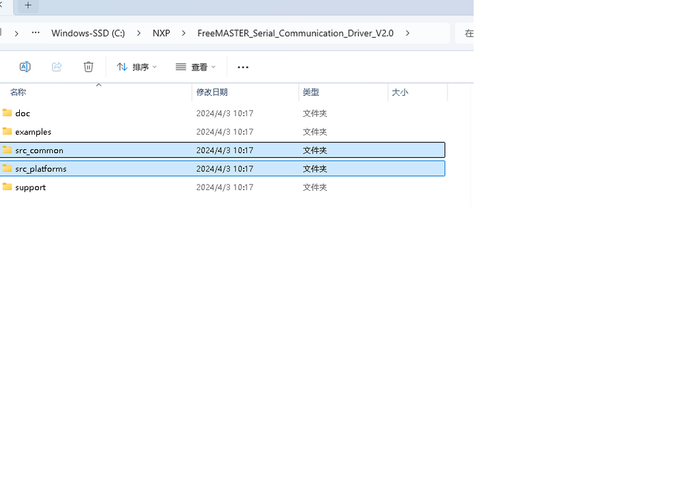

Thanks for your reply. i find the src_common and src_platform files and put them in my project. I find my many example about intergrating freemaster in project. but no example is find intergrating freemaster with MQX project. could you please give some hint? thanks.

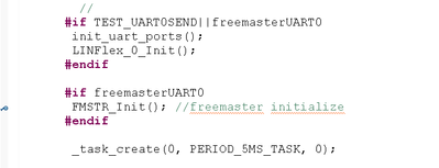

I follow your guide and add common file and src_platforms/MQX files. and i add freemaster task. and please see code snapshot. but i still faild to connect. In order to verify if my hardware is ok, i test uart transmit and successed to send data out from board.
wendywendy_0-1728479050324.png I put  FMSTR_Poll() in PERIOD_5MS_TASK
wendywendy_1-1728479194066.pngthis is detailed of period task content.
wendywendy_2-1728479264216.png this is uart iniltialization. I put a break point here. I find the code is stuck here( "FMSTR_Init()"; )
when dig into the function, the code stuck in blow position. it seems that code can not open communication port.
based on the above information, which direction should i go to check? could you help me ?

if code gets stuck in opening the "ttya:" device, then I would check if this device exists and can be open in a simpler hello-world application.
It is really a long time ago we did the MQX port, but what I remember is that we were using "ittyX:" devices which are based on interrupt-driven concept. I think (not sure) that with a blocking mode configured using FMSTR_MQX_IO_BLOCKING, you must use an itty device.
Also, make sure you use a different serial port than used for MQX console (BSP_DEFAULT_IO_CHANNEL).
