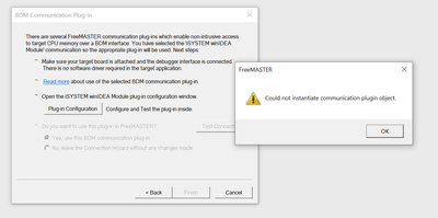

FreeMaster not connecting to Sk32K3xx board via iSystems
927 Views
EmbeddedSWUser
When using the connection wizard then selecting connect through a debugger probe/on board debugger interface and selecting winIDEA debugger environment from iSYSTEMS then using direct access to target microcontroller memory and then did the following.

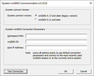

this looks like an issue of FreeMASTER installation. With FreeMASTER NOT running, please open your file explorer in "c:\NXP\FreeMASTER 3.2\FreeMASTER" and run the register.bat using the context menu "as administrator".
This is how the plug-in configuration should look when you start FreeMASTER again:
