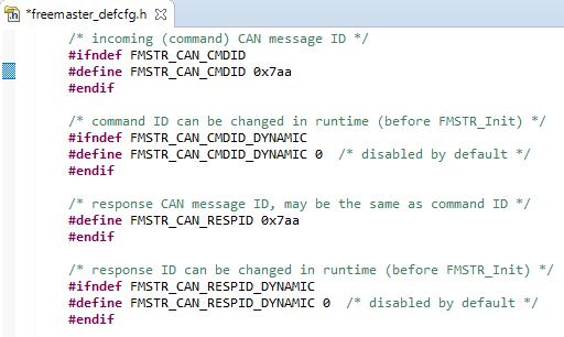

Thanks for the quick response. Setting the TSA variable to 0 worked and I was also now able to build my simulink model successfully. The next problem I am facing is over FreeMaster itself. In the connection wizard I selected the "Connect over CAN bus" option and after that, in the plug-in configuration options, I set the Driver and baud rate based on my model and the CAN device I am using to connect to my PC.
However, clicking on Test Connection, I get an error saying "No board detected". I think the issue is with the Command Message ID (it is set to the default value in FreeMaster and I am not sure which is the correct one). How do I fix this error and how do I find the Command Message ID if it is in fact the cause of the problem?
10,827 Views
iulian_stan
0x7aa is the default Command ID used by both FreeMASTER library and desktop tool, so you don't have to change it.

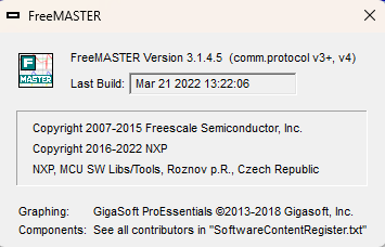

I then tried to check if FreeMaster is indeed using the Driver 2.0 and under "About FreeMaster" I can see that it says comm protocol v3+, v4. Does this mean it is not using the Driver 2.0? If that is the case, how do I make it use 2.0
I tried it with FreeMaster version 3.0, 3.1 and 3.2
10,816 Views
iulian_stan
FreeMASTER (desktop tool) shows the latest supported protocol version. It is backward compatible with older protocol versions including v2 (which should be your case):
It is recommended to always use the latest eversion of the Desktop tool.
