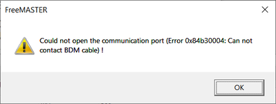

I am following the WCT1000 A11 Reference Design System User’s Guide (https://www.nxp.com/docs/en/user-guide/WCT1000SYSUG.pdf) , section 6.2.4 Using the FreeMASTER GUI for calibrationto configure and connect FreeMASTER to the WCT-5W1COILTX evaluation kit. However, I can't seem to connect. I am using the FreeMASTER project file located at WCT1000_A11_V3.3\example\WCT_A11.pmp with the following project configuration:
When I try to connect, this is the error I receive:
Note that I am running the project in its default configuration as received from NXP. The only thing I have changed is the following:
#define LOW_POWER_MODE_SUPPORTED FALSE
The following #defines are already set in the project (default values) but copied below for reference:
/* WCT1xxx only: JTAG communication */
#define FMSTR_USE_JTAG 1 /* wct1000: use JTAG interface */
#define FMSTR_USE_JTAG_TXFIX 1 /* wct1000: use SW workaround for JTAG TDF bug */
//----------------------- FreeMASTER Support -------------------------
#define FREEMASTER_SUPPORTED TRUE
Also, I am able to use Code Warrior to program and debug the board without issue using the USB TAP, so I know the debugger hardware is working and connected properly per the user guide linked above.
Here is the full FreeMASTER log:
[19:32:21.747] OpenPort
  [+4.800 us] plugin connect string:EONCE;addr=localhost;core=56F8xxx
  [+21.600 us] OpenPlugin() done [ERROR code=0x84b30004]
  [+0.564 sec] done [ERROR code=0x84b30004;]
[19:32:22.311] ClosePort done [OK code=0]
Can someone provide some insight into why the connection may be failing?

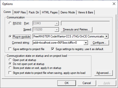

the BDM JTAG/EOnCE plug is supports the P&E Micro Universal and P&E Micro Universal FX interfaces only. Please use this interface if possible. It is more convenient than using USB-TAP with FreeMASTER.
The USB-TAP device needs to be accessed over a local CCS service installed in "c:\Freescale\CW MCU v11.1\MCU\ccs\bin\ccs.exe". This service starts automatically when a debugger session is started. It runs almost invisible in bottom-right system tray area - as this icon:
Steps to connect:
  • Run a normal CW debugger session
  • Notice the ccs server has started.
  • Click the system tray icon with the right mouse button and select "Show Console"
  • In the console, go to menu File / Save configuration - save to any file. This is a USB-TAP setup needed for DSC connection.
  • Finish the debugger session - the ccs server closes (it can be configured to leave running).
  • If not running, start the ccs.exe manually
  • Open console and load the DSC configuration file previously saved.
  • Start the FreeMASTER and select CodeWarrior-CCS JTAG/EOnCE plug in
  • Configure it for the localhost connection and try to connect with FreeMASTER.
The FreeMASTER is not commonly tested with USB-TAP device. Use of P&E Micro is the recommended option. Please let me know if you have any issues when connecting.

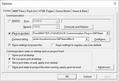

Hey Michal,

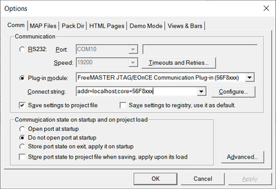

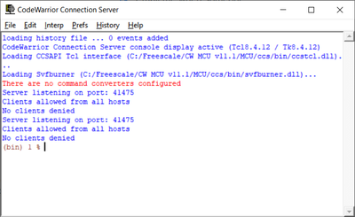

Thanks for the info! I am still receiving the same error after performing the steps you indicated with the USB-TAP:
I followed your steps to establish a debug connection in Code Warrior 11, saved the config, closed code warrior, manually ran ccs.exe, and loaded the config. Here are a few screenshots of the output and my FreeMaster configuration.
ccs.exe running with saved config:
FreeMASTER configuration per your screenshot:
A few questions/comments:
1. If the USB-TAP debugger is not regularly tested and I presume being phased out, then why are NXP and distributors still selling it? Seems like the documentation for these wireless charging products should be updated to reflect this.
2. I noticed that my FreeMASTER plug-in module selection is slightly different from your screenshot. Your screenshot shows "FreeMASTER CodeWarrior-CCS JTAG/OnCE Communication...". The closest one available in my FreeMASTER 3.1 installation is "FreeMASTER JTAG/EOnCE Communication...". Is there any difference between the two and why does my FreeMASTER plugin name differ from yours?
3. Since we need to run charging calibration in our final design of our custom board, we plan to use UART for communication with FreeMASTER. Can I reconfigure this project (WCT1000_A11_V3.3) to use UART to communicate with FreeMASTER? If so, how do I do this? It looks like QSCI0 is brought out to TP40 and TP41 on the Debug Board.

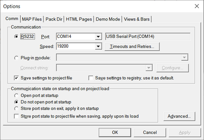

Edit. I figured this one out myself and got it working. Providing what I found worked for others to reference. Set the following:
#define FMSTR_USE_SCI 1
#define FMSTR_USE_JTAG 0
You can then use TP40 (TX from MWCT1000 to PC) and TP41 (RX to MWCT1000 from PC) on the Debug Board along with a USB-TTL cable. Then configure FreeMASTER as the following:

Kaifeng

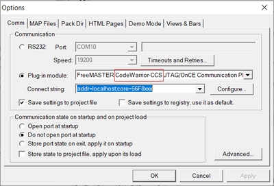

Hi, please note the diff marked in the red frame, I choose this plug-in mode with FreeMASTER 3.1.2.4, the USB TAP can work normally.
Thanks.

MichalH
NXP Apps Support
NXP Apps Support
One more note: The FreeMASTER 3.x installer does not contain the jtagpgi.dll which implements the CodeWarrior-CCS plug-in. This is intentional as the USB-TAP was not on the compatibility list for FreeMASTER v3.
If you install FreeMASTER 2.5, the jtagpgi.dll will be registered and will be usable also in FreeMASTER 3.x - as Kaifeng wrote.
Note: After installing FreeMASTER 2, all other plug-ins may be re-registered (stolen) from v3. So after version 2 is installed, please install the v3 again (or just run "c:\NXP\FreeMASTER 3.1\FreeMASTER\register.bat" as an administrator).
