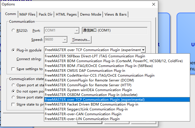

Hi,I want to connet my target device via Ethernet port, does freemaster support this function? I found TCP communcation configuraton in "Option" dialog, but can not find any introduction in freemaster softtware user guide. Can I use this communcation function?

Dear user,
direct TCP or UDP communication is not yet available in FreeMASTER. We have it in our plans, but the release is not scheduled for this year.
You are correct that there is an experimental version of the TCP plug in in the list, but this is currently not usable.
