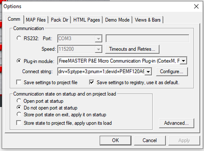

Dear all,
I try to use MPC5748G (silicon version 1N81M) with freemaster version 3.0.2.6 with option "BDM connection Nexus2+ memory access". I use PE micro Multilink Universal FX debugger. I can establish a proper connection to MPC5748G ("Test Connection" reports no problems). But all variables I'm watching returns 0. If I use option "background memory access" everything works as expected.
Whats wrong here?
Jörg

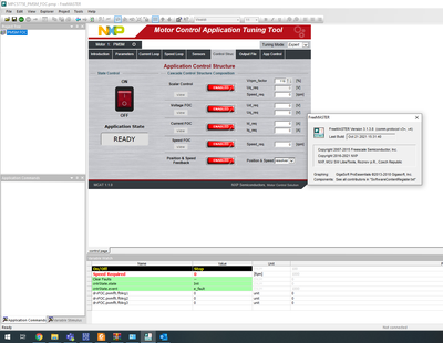

can you confirm you are using the latest FreeMASTER 3.1.3? Also, can you send me screenshots of your FreeMASTER - P&E plug-in Configuration dialog and a screenshot of a message which appears after pressing the Test Connection button in this dialog?
Do you also see an automatic firmware update of the P&E Micro interface when connecting with FreeMASTER - like Jobu had reported before?
Are the other symptoms same as Jobu had seen? (connection is established well, but variables read as 0). When you use Background Memory Access (stops core), do the variable values appear correctly?
Michal
14,619 Views
Enver
Hello Michal,
I confirm that use lastest version:
I saw firmware update at first connection with MCU. Other times, I didn't see anytime after that. I guess firmware in multilink-fx is 10.81.
Use Nexus2+memory access,  connection established well, but read as 0 all variables and board doesnt gave any response from freemaster button or current demand.

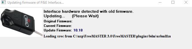

I update Multilink firmware with PEFirmwareConfig tool to usbmlfxufjtagens.1018 (should be latest version).
If I connect to freemaster and test the connection to the targed the firmware is automatically updated from version 10.18 to 10.36.
But at the end of the update process 10.18 is shown as the new version.
I could not find a difference in firmware images comming from P&E update tool and the ones provided with freemaster installation. Why is the update started? Could there be somthing wrong with the firmware update? Can you see the same at your side?

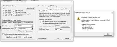

The connection test shows this result:
Is BDM version 0.0 correct?
Jörg
15,826 Views
MichalH
NXP Apps Support
NXP Apps Support
Hello Jörg,
when testing on our side, Lukas also sees BDM version 0.0, so I believe this is correct. The set of P&E firmware files included in FreeMASTER 3.0.2 has been provided by our partners in P&E directly, so I believe it is correct too.
The reason why you see intermediate update to 10.36 is most likely the update of Multilink bootloader (usbmlfxufbootens), later followed by update to Qoriva/PX firmware usbmlfsufjagens to version 10.18.
Just to be sure, you may use the official P&E updater (PEFirmwareConfig.exe) and remove all firmware images from c:\NXP\FreeMASTER 3.0\FreeMASTER\plugins\bdm to prevent any further update. But I do not think this is going to help.
