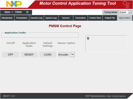

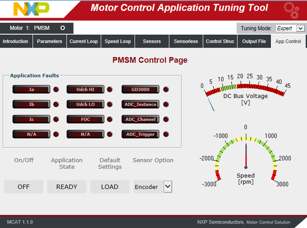

If MCAT “App Control” tab is not displayed correctly like in the picture below, where gauges and fault indicators are missing, it is because a gauge component was not registered automatically in the windows system.tomasfedor_0-1671009414926.png
  In order to fix this this issue apply following step to register gauge component:

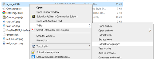

2. Extract agauge.CAB file located in C:\NXP\MC_DevKits\MCSPTE1AK344\sw\MCSPTE1AK344_PMSM_FOC_2Sh_ll\FreeMASTER_control\MCAT\control_page
NOTE: You may use any archive software with CAB archive support includes WinZip, WinRAR or 7-Zip.

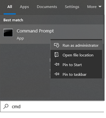

3. Run command prompt as an administrator.

After gauge has been successfully installed you can open the FreeMASTER project and MCAT “App Control" tab will display correctly.tomasfedor_5-1671010297964.png

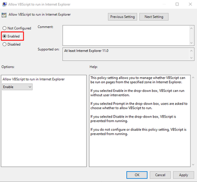

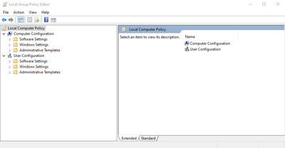

If this guide doesn't work on your side, the problem might be in disabled VBScript in browser engine.
To fix that, you may edit this settings in Local Group Policy Editor.

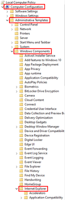

for open click on Start and start writing "Group...". Search engine will offer you "Edit group policy". Or you may press "Win+R" and in the "Run" window type gpedit.msc

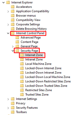

Now navigate to Computer Configuration> Administrative Templates> Windows Components> Internet Explorer> Internet Control Panel> Security Page> Internet Zone

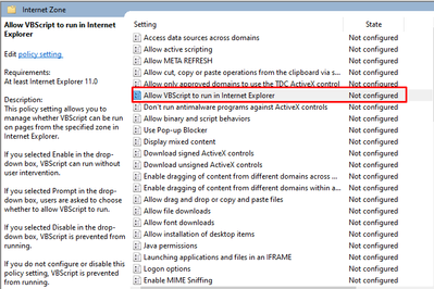

Double-click and edit the Allow VBScript to run in Internet Explorer setting.
Close Local Group Policy Editor, restart PC and open FreeMASTER project again.
I hope it helps you.
