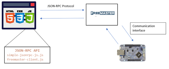

FreeMaster allows us to create HTML pages with Javascript to interact with our embedded application, and access the FreeMaster features, allowing us to create complex and personalized user interfaces. FreeMaster gives us two options for rendering and communicating our HTML page: Internet Explorer or a Chromium rendering engine. The Chromium rendering engine (which is the base for modern browsers like Google Chrome, Microsoft Edge, and Opera)  is the more modern option, supporting asynchronous JavaScript programming and other modern scripting technologies.
The Chromium rendering uses the JSON-RPC protocol to call the procedures on FreeMaster. JSON-RPC is a remote procedure call protocol that use JSON to encode its data, in this case, is used to call procedures from the FreeMaster application,
 FreeMaster gives us a JSON-RPC API for Javascript that facilitates the communication between the HTML page and FreeMaster.

Example Description
In this example, we are going to use the JSON-RPC API to connect an HTML page to FreeMaster. The HTML page will be capable of reading a variable and modifying a variable, the HTML page will also plot the read variable. This example is based on a FreeMaster project that calculates the value of a sine line based on an angle that is constantly incrementing, you can find the description of the project in How To implement an interface using FreeMaster.

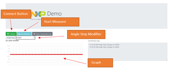

For this example, the HTML page we want to connect with FreeMaster looks like this:
This document is not meant to teach you how to design or create an HTML page, but to connect the HTML page with our FreeMaster project. The elements of our HTML page that will communicate with the FreeMaster Project through the JSON-RPC API are the next:
  • Connect Button: The connect button will star communication with the board and the FreeMaster project.
  • Start Measure Button: The measure button will start the reading operation for the sin_value variable.
  • Angle Step Modifier: This input will write the angle_step variable in our project.
  • Graph: The graph will plot the sin_value that has been read.

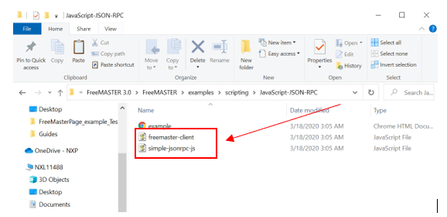

FreeMaster provides us with a “freemaster-client.js”  file available in the FreeMaster installation folder. This file is based in a popular JSON-RPC javascript library for generating and parsing messages called “simple-jsonrpc-js”, this implementation is also found in the installation folder and you can find the full documentation here: https://github.com/jershell/simple-jsonrpc-js.
To connect our HTML page with the FreeMaster application using the JSON-RPC interface we need to use a Javascript wrapper object that contains all the methods of the JSON-RPC API. The object is named as PCM and it is declared in the “freemaster-client.js” file, we access the API methods through the PCM object.
In summary:
 The complete address of the “freemaster-client.js” and the “simple-jsonrpc-js” in the installation folder is:
C:\nxp\FreeMASTER 3.0\FreeMASTER\examples\scripting\JavaScript-JSON-RPC
We will need these files to connect to our HTML page with FreeMaster, copy the files to your HTML page project:

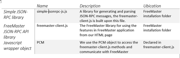

Next, we need to instantiate the Javascript wrapper object that we import in the “freemaster-client.js”. To do that, you need to create an external Javascript file and import it in our HTML document or implement it inside a script element in the HTML document.
The wrapper object is named PCM, the implementation of the PCM object in the freemaster-client.js file looks requires the following arguments:
var PCM = function(url, onSocketOpen, onSocketClose, onSocketError)
The url refers to the direction of the web server we are going to connect, when we open the FreeMaster application it initializes the JSON-RPC server listening on port number 41000. So our url should be “localhost:41000”.  The next three arguments ask for handlers to execute when connecting to the server when the server is close and a handler in case an error occurs during communication. To use these handlers we first need to create them, in the form of Javascript functions and then we can pass them like callbacks (a function pass it as an argument to another function).

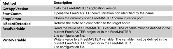

Some useful methods of the JSON-RPC API are listed below:
A full list can be found here:  FreeMaster User Guide.

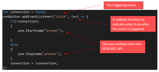

API Methods: StartComm and StopComm Example
The StartComm and StopComm methods open and close the communication port. They receive the name of the port as an argument, the special name “preset” identifies the default connection built in the FreeMASTER desktop application.
In our example, we are going to use these methods in index.js when we click the connect button, as you can see we obtain the button with DOM manipulation and use the methods in the event listener.
At index.js
let conButton = document.getElementById("connectBtn");
let connection = false;
conButton.addEventListener("click", (ev) => {
    if(!connection)
        pcm.StartComm("preset");
    else
        pcm.StopComm("preset");
    connection = !connection;

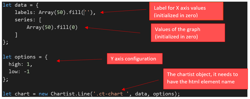

The charts in chartist take an object that contains the data, which must consist of two series describing the data and the labels on the X-axis. Another object can be given indicating the values of the Y-axis.
In the Javascript script (index.js) we write this at the beginning of the document:
let data = {
    labels: Array(50).fill(''),
    series: [
        Array(50).fill(0)
let options = {
    high: 1,
    low: -1
let chart = new Chartist.Line('

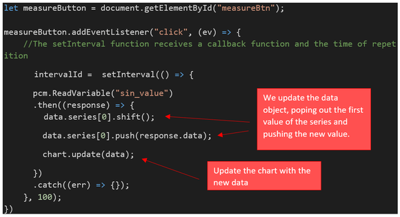

Now, to update our chart with the values that we are reading from our board we are going to modify the event listener that we create for our Measure Button, instead of printing the response of our ReadVariable method, we are going to use the response to update the data object of our chart:
let measureButton = document.getElementById("measureBtn");
measureButton.addEventListener("click", (ev) => {
    //The setInterval function receives a callback function and the time of repetition
intervalId =  setInterval(() => {
      pcm.ReadVariable("sin_value")
      .then((response) => {
        data.series[0].shift();
        data.series[0].push(response.data);
        chart.update(data);
      .catch((err) => {});
    }, 100);
With this, we have set up the chart to update the values of our embedded application. Again, this is specific for the Chartist.js library, although it can serve as a reference for other libraries.

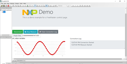

Running the HTML Page in FreeMaster Desktop Application

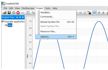

We can run our HTML Page either in our browser or in the FreeMaster Desktop Application.
Opening in the Browser
To run in the browser open the FreeMaster project in the FreeMaster Desktop Application and then open the HTML page in the browser:
Opening in the FreeMaster Browser Application

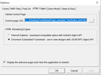

For the FreeMaster Desktop Application, we need to go to the options of our FreeMaster Project:
Go to the HTML page section, there select the HTML file in the “Control page URL” input, and then select the “Chromium Embedded Framework” in the HTML Rendering Engine option:
