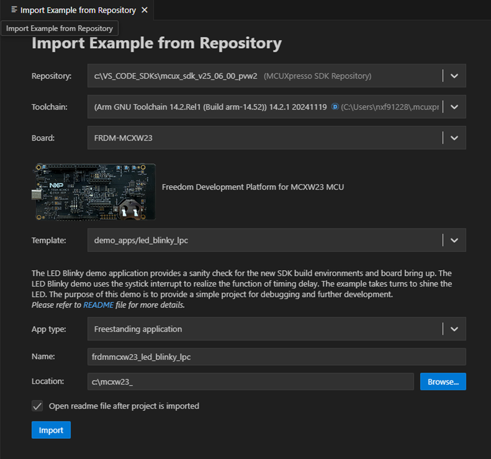

  1. Open VSCode and follow the steps in this section to import the led_blinky example from SDK, belonging to the demo_apps section in the MCUXpresso SDK as per the following snapshot:

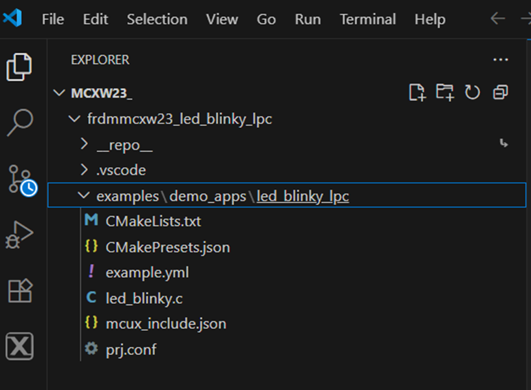

  2. Click on Import button to import the full project into your workspace. Check the frdmmcxw23_led_blinky_lpc project in the Project explorer tab.                                neidys_vargas_3-1755618809265.png

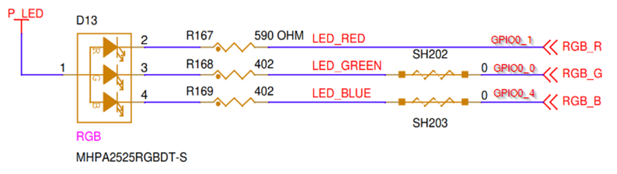

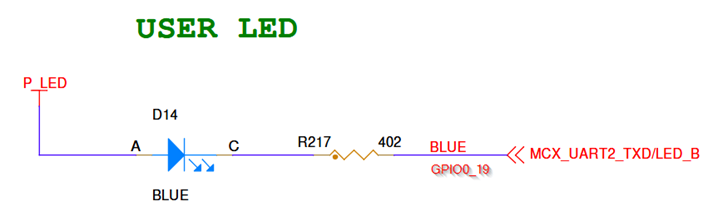

Now is time to play with the code. In the next steps we will add a new blinking LED. Having a look at the schematic of the FRDM-MCXW23 board in the RGB LED section, we notice RED is connected to GPIO0_0 and BLUE is connected to GPIO0_4 while the RED LED (digging a little more in depth in the document) is connected to GPIO0_1.
neidys_vargas_4-1755618955083.pngneidys_vargas_5-1755618977045.png neidys_vargas_6-1755618994883.png
What we want to do is to have a RED LED blinking at the same one second rate but will blink in the inverse time as the GREEN LED, this means when RED is on BLUE is off and vice versa.  To do this we will add few code modification.
