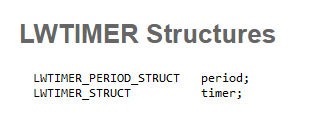

      2. Prior to creating a timer queue and a timer to put in that queue we need two structures, one of type LWTIMER_PERIOD_STRUCT and one of type LWTIMER_STRUCT. These don't need to be global and can be declared at the top of the Input Task.

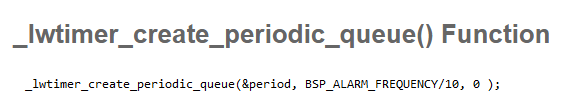

      3. The lwtimer periodic queue needs to be created which can be done with the _lwtimer_create_periodic_queue() function. It would make sense to create this in the Input Task just after the lwevent group is created. The periodic queue should have a period of 10 Hz, however the period needs to be expressed in system ticks so this number will have to be converted. The number of ticks / second for the system is defined in the board specific header file of our BSP, in this case twrK70f120m.h. In there you will see a define for BSP_ALARM_FREQUENCY which is set to 200. For a period of 10 Hz then our timer should be expiring then every 1/10th of a second, or every 20 ticks. To write code that is easier to follow and more transportable it is better to define the period in your function call as 'BSP_ALARM_FREQUENCY/10'. In our case there is no point to have a delay before the timer queue starts so this can be left at 0 in the _lwtimer_create_periodic_queue() function call.

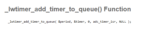

      4. Now that the timer queue has been created you can add a timer to that queue using the _lwtimer_add_timer_to_queue() function. Reference the structure of type LWTIMER_STRUCT that you already declared and select an offset of 0 ticks. A timer ISR function to be called when the timer expires is required so you can select a function name now for this ISR (eg: 'adc_timer_isr') and we'll write this ISR shortly. We won't need a parameter to be passed to our ISR so you can set this parameter to 'NULL'.

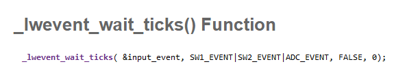

    1. In the next lab we'll set up the Input Task to read the ADC value when the timer expires. But since the ADC interface hasn't been covered in the course material yet we'll skip that step and simply send a message to the Health Task to indicate that the timer has gone off. The Input Task will need to unblock when timer expires so the _lwevent_wait_ticks() function should be updated accordingly.

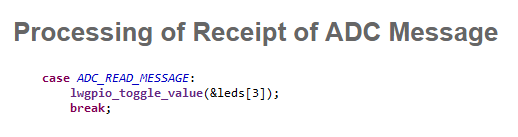

    1. The Health Task passes all messages on to the Display Task and we should update the display task to indicate that the timer is working. For now we'll toggle the state of the blue LED (which is LED[3]). Add the handling of an ADC_READ_MESSAGE in the Display Task. When this message is received, use the _lwgpio_toggle_value() function to change the state of the blue LED.

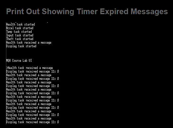

  1. Compile and run your code. You should see the blue LED changing state rapidly, ie every 1/10th of a second so it will flash on 5 times per second. The Timer Expired message should be seen continuously printing as well.
