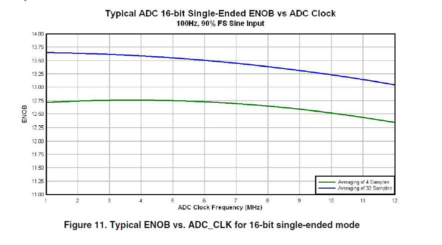

i have a MC56F84769 controller. My bus clock is 50Mhz.
In the register ADC16_CFG1 I can select the clock divide settings (see below). The data sheet specifies that I need for 12Bit mode to keep inside 1.0 — 18.0Mhz.
If I change the divider settings between 4 and 8 during conversion my result changes although I am within the specified frequency.
Any ideas?

Hi, Andreas,
As the following Fig in data sheet of MC56F847xx, the higher the ADC clock frequency, the less the ENOB spec, accordingly more the noise is. For high accuracy, pls decrease the ADC clock frequency to 1MHz.
Hope it can help you.
Xiangjun Rong
