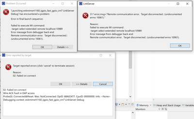

After trying to manipulate TCM bank numbers, I am now unable to program the target. I moved to the hello world sdk project and unable to find the target. Did I brick the processor? See attached images.

Working through the document above (https://community.nxp.com/t5/i-MX-RT-Knowledge-Base/RT-board-recovery-for-debugger-connect-issues/ta...), it didn't allow me to connect to the processor. I worked through both the IDE using the Erase Flash using LinkServer and using the MCUXpresso Secure Provisioning tool. I attached the error messages below but in short I am unable to find the target. This seems like an internal fuse blown, but want to confirm that. Is their an easy way to confirm that using the IDE or are the error messages attached allow me to find another way to wipe flash? Is their a special configuration off DIP switch SW1 to allow an ability to wipe flash memory.
Image_3 and Image_4 - Attempting to use the LinkServer Erase Flash tool
Image_5 - Attempting to connect to the target using the Secure Provisioning tool

I have ran back into this issue again. This is the errors that I get when attempting to debug through the linkserver.
I am able to find the probe through the Redlink Server. During debugging/flashing of the compiled code I get this notification from the console.
I attempted all of the tasks above and it doesn't work to allow me to reflash code.
If their is any other ways to get access to the target, it would be greatly appreciated.

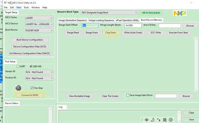

Enter the serial download mode, then  power off and power on the board again.
If you still have issues about it, you can use the MCUBootutility, use this tool connection and do the mass erase in the serial download mode, I believe it's OK, otherwise, your board my have issues.

Hi @JSuciu ,
 Don't worry, you won't brick the processor, unless you burn the fuse.
Now, your issues is download the invalid image to the flash cause the boot issues, you can follow my document to recover it:

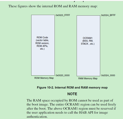

When you do the TCM configuration, please to avoid the ROM used TCM,
You also need to care about the flashloader used TCM, eg, the flashloader in the DTCM, but you set the DTCM=0, then you also will meet the issues, as the debugger flashloader no space to download the code.
