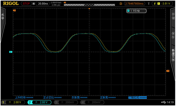

The demo code demonstrates the feature of Fraction Delay logic with Micro-Edge Placement  the eFlexPWM. The SM0 module outputs two channels PWMA_A0 and PWMA_B0. This is the configuration:for
PWMA_SM0VAL2= PWMA_SM0VAL4=0xfffd, PWMA_SM0VAL3= PWMA_SM0VAL5=0x03, and PWMA_SM0CTRL2=0x2000;
PWMA_SM0FRCTRL=0x8104;
PWMA_SM0FRACVAL1= PWMA_SM0FRACVAL2= PWMA_SM0FRACVAL4= PWMA_SM0FRACVAL5=0x00;
PWMA_SM0FRACVAL3=0xf000;
From the above configuration, the PWMA_A0 and PWMA_B0 are in independent mode and the main duty cycle is the same. But PWMA_SM0FRACVAL3 is assigned with 0xF000, so the falling edge of PWMA_A0 will have a fractional placement as the following figure.
The code is developed under CodeWarrior for microcontroller ver 10.6 and processor Expert, TWR-8200 board.
In the above figure, the there are two channels which are superimposed together so that user can compare the timing.
The channel1(yellow trace) is the PWMA_A0 signal with a fractional edge placement which is connected to pin9 of J510 on TWR-8200 board. The Channel2(pink trace) is PWMA_B0, which does not have fractional edge placement and connected to pin11 of J510.
