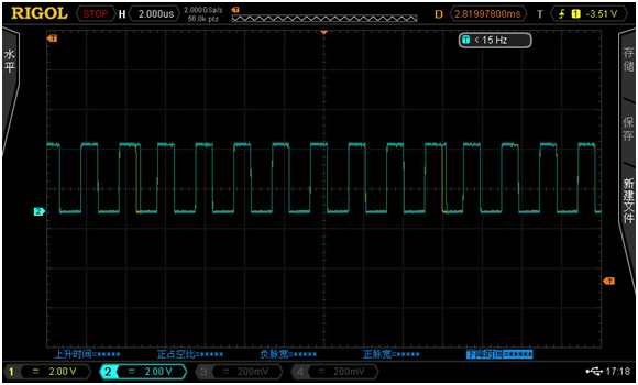

With the above figuration, the PWMB_SM0 is set up in independent mode, and the PWMB_A0 and PWMB_B0 should have the same waveform if there is not fractional feature.
After the fractional Delay logic with dithering sub mode is enabled, the duty cycle of one PWM cycle out of 8 PWM cycle is different.
In the figure, two channels PWMB_A0 and PWMB_B0 are displayed, because the two signals almost have the save waveform, so they are superimposed most of time, but there are two cycle which are different. The Yellow channel on the oscilloscope  is pin 23 of J503( GPIOG2 or  PWMB-B0) signal, the pink channel is pin24 of J503(GPIOG3 or  PWMB_A0 )signal.
You can see one one duty cycle among 8 PWM cycle is different.
