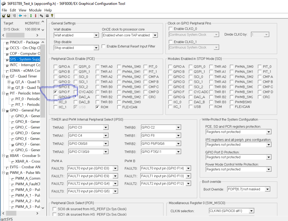

      I create one project about FRDM-56F83000 (File-> New -> Project -> New Stationery Project, MC56F83789 -> MC56F83000-EVK -> C_Application), then compiling and programming are normal. But I added any code in main() function, the project could compile, and it could not program(the error windows appears). Why about this?
      The attachment is the error information.

xiangjun_rong
Hi, Derek Xiang,
After I modified your code, I can debug your code as the screenshot.
As I said, if you create a project based on Quick Start tools, you have to load the GCT and setting the GCT correctly.
Enable GPIOF gated clock in GCT tools
//set up GPIOF8 pin as output
//add the code in while(1):
            ioctlGPIO_SET_PIN(GPIO_F,BIT_8);
            ioctlGPIO_CLEAR_PIN(GPIO_F,BIT_8);

HI, Xiangjun,
      I have already installed the quick_start tools according to this PDF document.PG4.png
