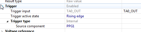

I am setting up a PE ADC High level component and am having a problem with the Internal Trigger, Trigger Input settings.  This is for a 56F82748 DSC and using the 12 Bit Cyclic ADC.
I get the following error in the ADC Component setttings.
and in the Problems it shows the following Errors.
The strange thing is that the ADC_LDD driver that the ADC High level component is using is happy
  and it is set to the same TA0_OUT as shown below (set automatically from the ADConv component).

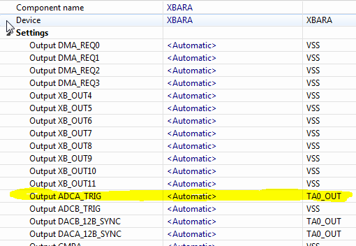

The error message seems to indicate that the XBARA is not set up properly.  So I added that component and the "Automatic" settings show that the timer I want to use is routed to the ADC.

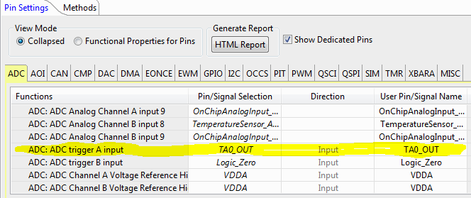

Also the Pin Settings component shows the ADCA Trigger Input connected to TA0_OUT.
To me this seems like a bug but maybe I missed something.
The only other thing I see that may be a clue is the errors showing up -
"ERROR: Internal signal "TA0_OUT" is selected. Device "TMR0_CNTR" of linked bean "TMR0_pwm" is not interconnected with device "ADC"!"
and "Routing peripheral is not selected/specified (Trigger input)"
 - but not sure why it is saying that since they seem to be connected through the XBARA.
