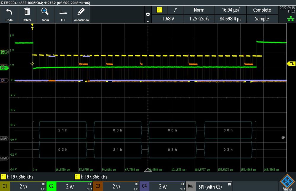

idanu357
Bellow is an image of the transaction.
The datasheet is a bit misleading I hope you help me understand this:
1.What is the "Register data" after the register address, is that the data the sent back from the  SC18IS600 ?
2. What is the Dummy byte ? do I really need it ?
My MOSI lines are 0x2100 to read the IOConfig in half duplex or 0x210000 in full duplex
Reading SPI lines:
Without the dummy byte reading I2CClock register:
With dummy byte reading the IOConfig register.
5,997 Views

Hello Idan,
you are very welcome. And thank you for the scopes. Both look ok to me.

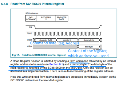

[A] The byte in the "Register data" is the content of the register, which address you enter in the second byte. After the command byte.
[A] Yes, you need the Dummy byte. It gives time to SC18IS600 to send the Register data to the MISO line.
In the first scope, you have the Dummy byte.
In the second scope, you have actually two dummy bytes and two Data bytes. Each on the MISO line each below one dummy byte.
Please check the pictures attached.

idanu357
Thanks Jozef,
I can see that the SC18IS600 is returning the right data, but for some reason the last bit is missing when i read it via the FTDI chip(USB to SPI).
The data in the code is different from the scope im getting 0x02 instead of 0x03 or 0x18 instead of 0x19 and its consistent for every byte no matter how many bytes im reading from the SPI.
If you can see any problem in the scopes(?) i will continue to investigate the code or FTDI driver.
