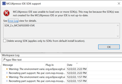

Is there any real support for MC56F parts? (specifically the MC56F8322 and MC56F8256)
I don't mean this to be a snarky question, I have downloaded the DSC8.3 IDE (so old it doesn't like 64bit Win10), tried getting the CW11.1 download (chat support was unable to tell me how to add MC56F to my licensed K60 CW for MCU install) and when I try the latest and greatest MCUXpresso IDE and try to Install a SDK from within the IDE it can't find the part and when I build and download the SDK zip I get the following:
Is support for these parts really this bad?
Is there a way to download the latest build tools (assembler, compiler, linker) and just use a makefile?

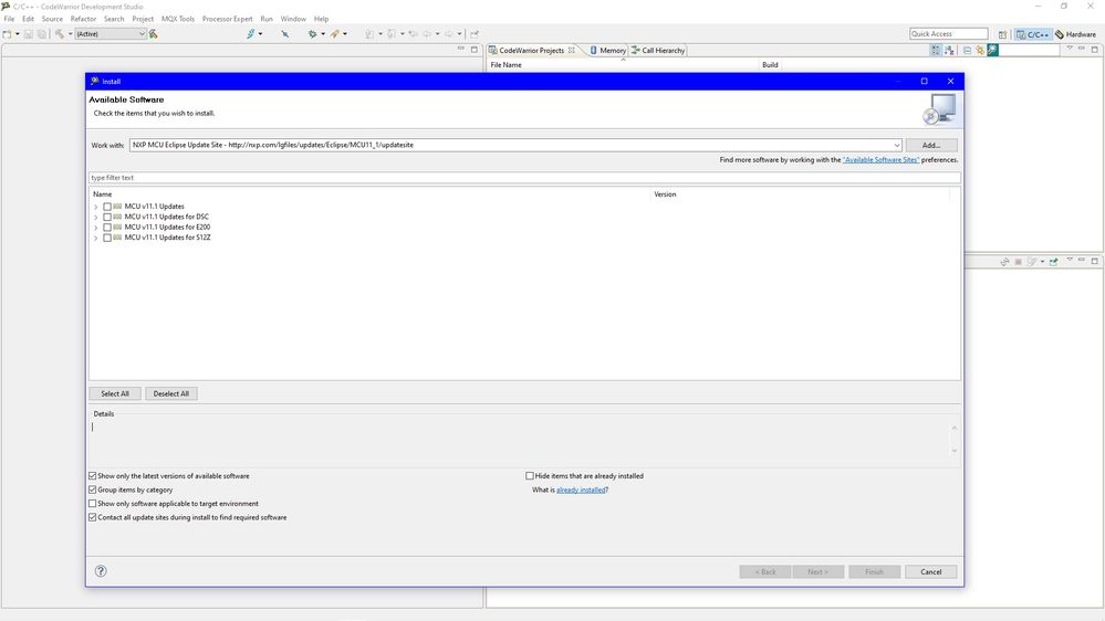

If you already installed CW for MCU with K60 support, maybe the default install/upgrade settings are set for K60 only.
Have you tried looking deeper in the "install new software..." options and enable the toolchains/tools/libraries for other MCUs ?
Try again with CW for MCU, select menu "Help" then "Install New Software..", select the NXP update site as shown below:
(the image above shows my update status, your dialog will look different, change the checkbox settings in the bottom of the dialog to view other optional installations).
Or maybe it's a problem due to the license for K60 not allowing to select other MCUs, have you tried with a separate clean installation of CW for MCU using the "free license" option ?

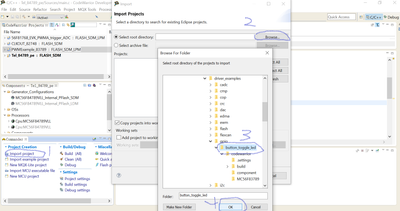

Unfortunately, the MCUXpresso tools does not support DSC family, you have to use CodeWarrior for MCU ver11.x to develop DSC family project.
I suppose that you have download SDK for DSC and the CodeWarrior for MCU tools ver11.x, I mark the steps to import an example in SDK, pls try to follow it up to load an example in SDK driver.
Hope it can help you
XiangJun Rong

I attach the user manual which demos how to load SDK example project in CodeWarrior for MCU ver11.x tools
Pls follow up it to load example in SDK to CW tools.
