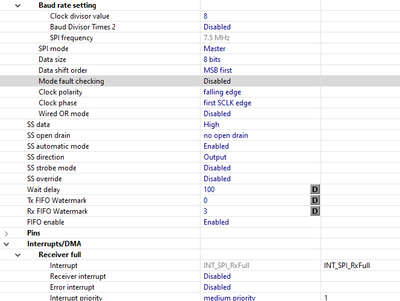

I have the peripheral configured as follows.
To send data, i only have to use "setReg16(QSPI0_DXMIT, value);" and it works just fine, the slave select as well (works with as much bites as I want to send). On the other hand, to receive data, I am having some trouble, as the data received seems to not be read in the correct order. Any tips?
