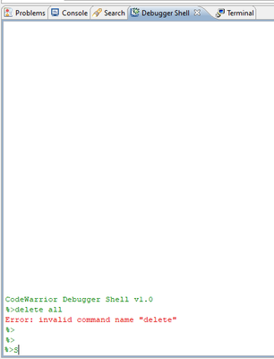

I am working on LA9310RDB, when i try to connect VSPA using cwide, it throws following error
"CCSProtocolPlugin::Can't connect to CCS"
I have configured the IP of jtag.
I also saw a link on the internet for the same, "https://community.nxp.com/t5/CodeWarrior-Development-Tools/Can-t-connect-CCS/m-p/459955"
But I am not able to understand anything from this, as it is a 6 year old post and CCS window is not there in CWIDE now

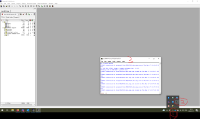

Where do i have to execute these commands, i cannot fine command line window in the cwide
3,011 Views
xiangjun_rong
It appears that you can not open the ccs menu, this is the screenshot which tells you how to open the ccs menu. I use the CodeWarrior for DSP56800E tools, but the menu is the same.
Hope it can help you
XiangJun Rong

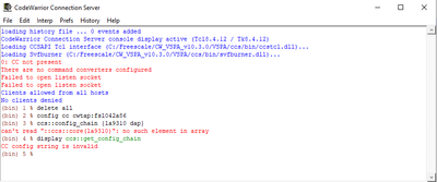

varun0106
Hi Xiangjun,
I started the CCS server manually from the cwide setup folder, then i started executing the commands which you have mentioned earlier, i got error in the third command "ccs::config_chain {la9310 dap}",
the error states "can't read "::ccs::core(la9310)": no such element in array,", what does it mean?
