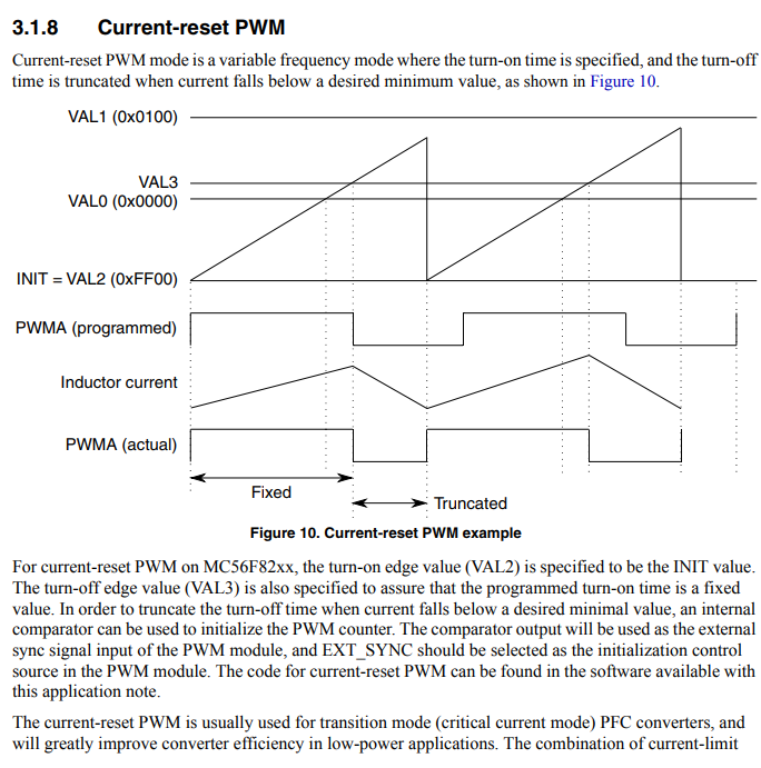

I want to know how to use the current reset PWM of eflexPWM module DSP MC56F82748. I want to utilize this pwm mode in order to drive a transition mode or critically discontinuous Boost PFC converter. Thank you!

Hi, Kien,
You gave me the section "3.1.8 current-reset PWM", can you tell me the documentation name?

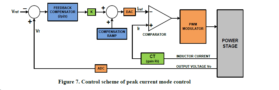

Regarding the current mode control solution, I suggest you refer to an4716.pdf, which I attached, you can see the Comparator generate signal to disable PWM signal as a Fault pin function.
You can download an4716.pdf from here.
https://www.nxp.com/docs/en/application-note/AN4716.pdf
Hope it can help you
XiangJun Rong

kienfrancis_ure
Hi the document name is "Using eFlexPWM with MC56F82xx DSC". We hope that
we can have a tutorial on this pwm. We think this will be the best solution
for our control. Thanks

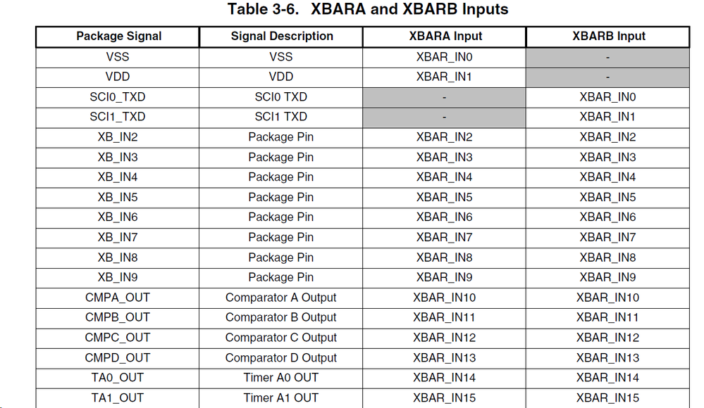

xiangjun_rong
Hi, Kien,
I see that you want to use current signal to reset eFlexPWM counter, in the case, you have to use a shunt resistor to transform current to voltage and use an on-chip or off-chip  CMP to get a digital signal when the current exceeds a threshold.
If you use on-chip CMP, you can use crossbar to route the CMP signal to PWM0_EXT_SYNC as the following screenshot in the MC56F827xxRM.pdf.
If you use off-chip CMP, you can connect the CMP output signal to any XB_INx pin, use the crossbar to route to PWM0_EXT_SYNC.
You can set the INIT_SEL bits as 2b'11 in PWMA_SMnCTRL2 so that the PWM0_EXT_SYNC signal can reset the PWM sub-module counter.
Xiangjun rong
