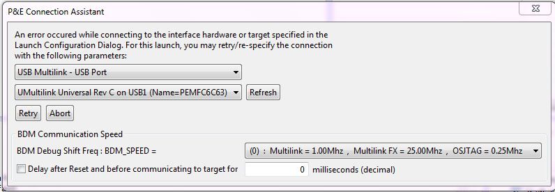

Hi I'm using USB tap for connectingMC56F82726(DSC). When I go through USB Multilink ref sheet it shows is can able to connect with DSC also. But I am unable to connect with USB Multilink since it requires extra two connections for DSC. What will be the connection for TRST and KEY? Other connections are available except TRST and KEY. Capture.JPG
I have added the pullup resistor for RDY/NC with 4.99K. But still it is not programming and shows the following error
From my schematic I have connected TDI to TDI, TDO to TDO, TCK to TCK, TMS to TMS, RESET to REST, TVCC with 5V_D, DGND to all GND of Multilink. Now I Pulled up the RDY/NC(13th pin of Multilink) t 4.99K, but it fails to program my MC56F82726 controller.
Any other necessary changes required from my schematic??

xiangjun_rong
The TVCC should be connected with 3.3V instead of 5V, the pin is driven by your target board 3.3V power supply.
Hope it can help you
