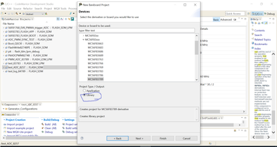

From your description, it appears that you want to develop your own library, this is the procedure:
1)File->New->bareboard Project, you will se the menu as following:
2)in the main.c, delete all the main function
3)add your own api function and compile.
Hope it can help you
